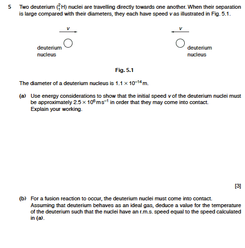

The above equation gives the EPE of two point charges separated by a distance r.
Firstly, I do not understand how this formula gives the TOTAL EPE of the system.
Secondly, let's say I have three deuterium nuclei moving towards one another with initial speed V.
They all stop instantaneously at the same point such that they are all separated from one another by distance r.
How would the above formula change to give the total EPE of the system ? Would you consider each pair of nuclei ?
So total EPE of system = (EPE of 1st+2nd) + (1st+3rd) + (2nd+3rd) ?
Hence, the formula becomes

Please have a look at the above image i.e. part (a)
You are telling me that no EPE is gained by one of the nuclei ?
So we consider the EPE of only one?
EDIT : How is that possible when both are moving towards one another and both are trying to overcome the repulsive force of the other ?
work done = force "dot" displacement
if they're both moving, wouldn't you expect the displacement of one to be halved, and the total distance to remain the same? :wink:

no, the result will be the same
but you can obtain it either by bringing one charge from infinity (zero work), then bringing the other charge (∫ F(r).dr)
or by bringing both charges from infinity together (∫ F(r).d(r/2) + ∫F(r).d(r/2)) :wink:

Before we all get confused, let's deal with the question in post no. 3 first.
Its alright to do that i.e. pretend one nuclei moves to the collision point and calculate the change in EPE (zero for the first one because both are at infinity at feel no repulsion) and calculate the change in EPE for the other ?
yes :smile:
(and there's no problem with the "fixed" one having speed v … we can bring the other one in as fast or as slow as we like, and the speed makes no difference to the force (if we're ignoring relativity))
