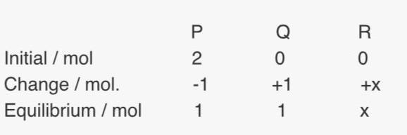

This is what I did:
Since they said at equilibrium, the total no. of moles is (2+x), so P and Q should have 1 mol each at equilibrium. So P and Q are in 1:1 ratio, but how do they know x is 1 ? Ans is B
Not necesarilly.
Write ICE table for each reaction separately and try to express total number of moles using equilibrium amounts (hint: some of xs will cancel out). The ICE table you wrote is wrong and doesn't fit any of the reactions. Change of P doesn't equal -1 in any of these reactions.

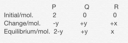

Oh yeah.. So if I let the change in mol of P be y ..
Is this right? So since the change in mol of P and Q are the same, i.e. y, and R is different, i.e. x, so that is why B is right?

First - as epenguin said, one variable is enough.
Second - you can't write ICE table not explaining to which reaction it refers.

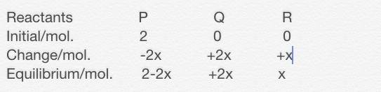

If only one variable is used, then the change in moles of P and Q would be 2x each right? Judging by the answer i.e. Mol ratio in the equation in B. But if the question did not give us any options, how do I know the change would be 2x? The change in concentration for P and Q are the same and they can be ANY number, but not 2 as the question said P partly decomposes.
Can you give me an example or some hints on how to write ICE table for each reactions separately? Sorry but I've only been taught to write ICE table this way :oops:

You are still ignoring the fact ICE table is built around the reaction equation. You can't say
as if it was an universal rule. Is your statement correct if the reaction equation is
7P ⇔ 3Q + 9R
or
P ⇔ Q + R
or
P ⇔ Q
where R doesn't even exist?
You are given 4 different reaction equations, you have to write ICE table for each of them separately, express - for each reaction equation - final total amount of moles using equilibrium values (yes, it will contain some unknown x, but that's what is expected) and compare it to the information given in the problem.
I guess all the time you are writing ICE table for the first reaction - if so, please state so, otherwise it is not clear what you are doing.

Oh I see, I got it now, sorry for the trouble. Thanks !
