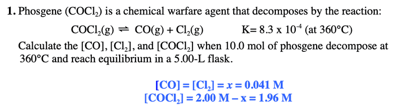

Phosgene (##COCl_2(g)##) is a chemical warfare agent that decomposes by the reaction
$$\mathrm{COCl_2(g)\rightleftharpoons CO(g)+Cl_2(g)}$$
with equilibrium constant ##K=8.3\times 10^{-4}## at ##360^\circ\text{C}###.
Calculate the ##\mathrm{[CO],[Cl_2]}##, and ##\mathrm{[COCl_2]}## when 10 mol of phosgene decompose at ##360^\circ\text{C}## and reach equilibrium in a ##5.00\text{L}## flask

Here is the answer provided by MIT OCW
Is this Kc, or Kp?
The question is asking for the final concentrations of the compounds. Your approach looks right but I didn't verify the numbers myself.
Going from amount of substance to a concentration should be piece of cake for you when you know the vessel volume, considering the work you showed here.
@Borek I'd be surprised if they gave Kc for a problem concerning gases.
Yes, but the answer given is suggesting calculations done with concentrations (2M is what you get after pushing 10 moles into 5L vessel), which is what made me wonder.

Suppose the given ##K## is actually ##K_c##.
Then, if ##x## moles of phosgene react to generate ##x## moles each of ##\mathrm{CO(g)}## and ##\mathrm{Cl_2(g)}## then at equilibrium we have molar concentrations of ##\frac{10-x}{5}##, ##\frac{x}{5}##, and ##\frac{x}{5}##.
##K_c## is then ##\frac{x^2}{10-x}=8.3\cdot 10^{-4}## which we solve for ##x## to get ##0.09##.
This doesn't alight with the given solution unfortunately.

Shouldn't it be ##\frac{x^2}{10-x}=(8.3\cdot 10^{-4})(5)##

Yes, you are right. I made an algebraic mistake.
We have
$$K_c=8.3\cdot 10^{-4}=\frac{\frac{x}{5}\frac{x}{5}}{\frac{10-x}{5}}=\frac{x^2}{5(10-x)}$$
which gives
$$x=0.201$$
and so the equilibrium molar concentrations are
$$\frac{(10-0.201)\text{mol}}{5\text{L}}=1.96\text{M}$$
$$\frac{0.201\text{mol}}{5\text{L}}=0.04\text{M}$$
So indeed the problem gave us ##K_c##.
