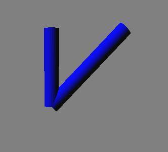

I have 2 unit vectors in the xy plane. I am constructing a pipe around each of these vectors. What I want is the ellipse that is formed at the origin(in 3D) when the two pipes meet. If the pipes are at 90 degrees the ellipse will be at 45 degrees. In general, the pipes are at obtuse angles but not necessarily.

There are two axes for the ellipse, at right angles to each other. How do these two axes depend on the direction of the two vectors?

I'm attaching a picture of two pipes. Their vectors are <0,1,0> and <1,1,0>. The ellipse should be the one joining the pipes at the origin. The axes of the ellipse should the normal of the two vectors and their angle bisector.
Thanks for the patience ;)
Claudio

Things don't work that way in 3D. There are many (uncountably many) rotations that take x to x', but only two will have the correct x'y' plane. (The y' unit vectors of the two solutions differ by sign.)
Fortunately, you do have a way to define all three axes. The two pipes define a plane. I assume you have vectors that define the orientation of these two pipes. The cross product of these two vectors is normal to each pipe. This forms the basis for one of your unit vectors (z'). You already have x'. y' is just the cross product of z' with x'.

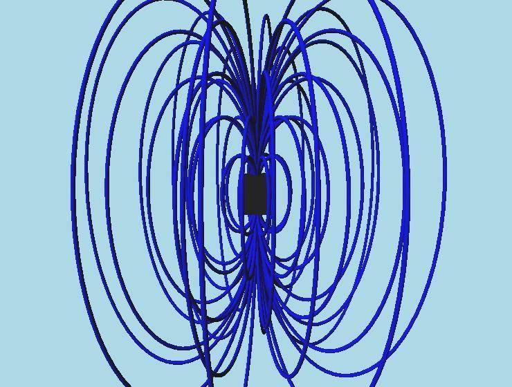

I'm attaching my first 3D magnetic field. :) It's just built up using ellipses with no physical equations whatsoever. Suggestions as to how it could be more realistic are welcome. The tool is aimed at high school students learning A Level physics.
Thanks for your precious help,
Claudio
