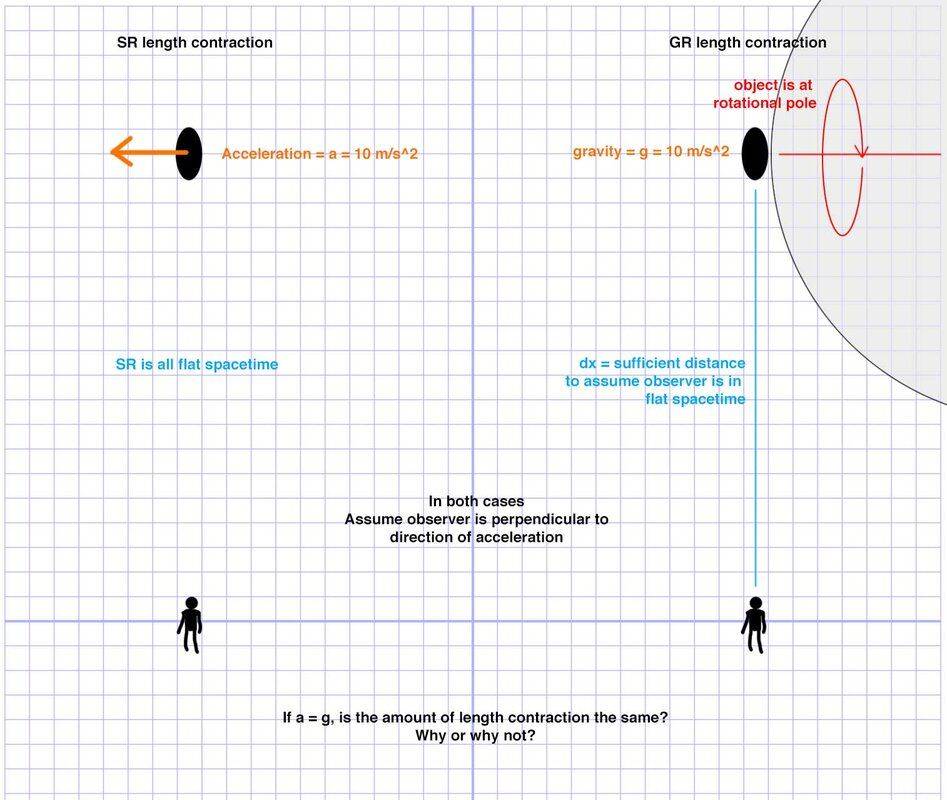

Are there any visual differences between the length contraction of SR and the length contraction of GR?
The 2 Bowling Balls
Ball(a) & Ball(b)
(a) is in acceleration of 10m/s^2
(b) is in at fixed position in a gravitational field where g=10m/s^2
In both cases the observer is:
- perpendicular to the vector of acceleration
- distant enough to be in empty flat space
Question : In an instantaneous rest frame of the observer, what distinguishes (a) from (b)?

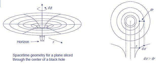

(b)’s length contraction is an visual effect of non-euclidian spacetime viewed from euclidian spacetime. So, I’d probably start with the Schwarzschild Metric for a non-spinning, non-charged black hole.
Take an embedding diagram for a 2D plane slice through the black hole, x,y being a euclidian coordinate system and z producing a parabolic curve such that distances measured on that curve correspond to proper length. (Thus z is a ‘unreal’ dimension used only for visual exposition of proper length). Use points r(1) & r(2) to define distance dr along the x-axis. r(1) & r(2), projected along the z-axis, meet the parabolic curve at points p(1) & p(2). Let the distance between p(1) & p(2) = dp = proper length
(please see slide 6 of ‘The Schwarzschild Metric : Relativity and Astrophysics, Lecture 34, Terry Herter. A2290-34.)
We see that dp > dr
dr
would then be the visualized contracted length.
(...I think this is all I’ll need to make some semblance of an bizarre math question...)
If we replace dr with Li, and dp with L, such that dp = dr/√1-(v/c)^2,
what is the velocity?

The obvious difference is that one is accelerating, and the length depends on velocity not acceleration, so its length changes over time.
It's also not at all clear what you mean by "length contraction in GR". It's an SR inertial frame phenomenon. You could certainly measure the angular subtense of the rod, but to what would you compare it? If you move the rod to flat spacetime or just let it free-fall, it'll stretch (or de-compress) because it's elastic. And light paths between the observer and the ruler would be different in flat spacetime anyway. You can't compare it to a co-located ruler because the ruler would also be affected by whatever effect you hope to measure.
I don't think your question has an answer, in short. If you want to know the angular subtense in the two cases then you can determine that, as I say. But that isn't really "measuring length contraction".

The GR phenomenon you are describing is not "length contraction".
Also, in both the SR and GR cases, there are other effects involved which complicate what is seen visually. In the SR case, you have Penrose-Terrell rotation. In the GR case, you have bending of light by the gravitating mass. So what you are imagining would be seen visually in both cases is wrong.
Furthermore, you appear to misunderstand how length contraction works in SR:
Length contraction in SR is determined by relative velocity, not acceleration. See further comment below.
You appear to be relying on the equivalence principle here to make the two cases "the same", but, while the EP does say that locally, the two observers in question, (a) and (b), will make the same observations (they both will feel the same weight, they both will observe the same acceleration relative to themselves of a dropped object, etc.), it says nothing whatever about how they will appear to other observers who are far away from them.
Apart from the issues I mentioned above, which complicate what is seen visually, there is the obvious difference that, since length contraction in SR depends on relative velocity, not acceleration, the length contraction of (a) will appear to be increasing with time to the distant observer, whereas the apparent "length" of (b) to the distant observer (ignoring the fact, mentioned above, that what is going on in this case is not "length contraction") will not change with time.
Even if we fix that by making the velocity of the object in (a) constant, there is still the obvious difference that in (a), the object is moving across the visual field of the distant observer, whereas in (b), it isn't.
What is non-Euclidean in the Schwarzschild case is space (more precisely, the geometry of the "static" spacelike slices--note that the "slice" you take later in your post is at a constant time, time is not involved at all), not spacetime. And, as already noted, the visual effect is more complicated than what you are imagining.
Meaningless. What you are doing here is nonsense.
The curvature of spacetime between the observer and the ball
