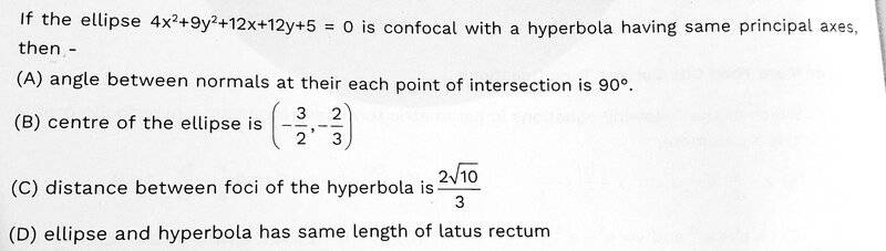

If the ellipse $$4x^2+9y^2+12x+12y+5=0$$ is confocal with a hyperbola having same principal axes then:
NA
The equation of ellipse reduces to :
$$(2x+3)^2+(3y+2)^2=8$$
$$\frac{(x+3/2)^2}{8/4}+\frac{(y+2/3)^2}{8/9}=1$$
Center of ellipse =##\left(\frac{-3}{2},\frac{-2}{3}\right)##
##b^2=a^2(1-e^2)=8/9## and ##a^2=8/4##
Therefore ##e=\frac{\sqrt{5}}{3}##
Distance between foci=##\frac{2\sqrt{10}}{3}##
Length of latus rectum of ellipse is 2 times the value of ##y## obtained on putting ##x=ae## and is equal to ##\frac{8\sqrt{2}}{9}##
Now comes the difficult part :
Finding the equation of hyperbola. I simply can't seem to do it.
For confocal hyperbola,
$$\frac{x^2}{a^2}-\frac{y^2}{b^2}=1\text{ and } ae=\frac{\sqrt{10}}{3}$$.
If principal axes have same length they become the same curve so I think principal axes are unequal in length but coincident.
I don't know what to do next ? I think there's insufficient information to get the equation of hyperbola.
Also just to clarify more than one options are correct so all need to be checked
The question does not imply there is a unique hyperbola meeting those conditions. The question is whether every such hyperbola satisfies A and D.
So without knowing the equation of hyperbol, how can A and D be verified?
