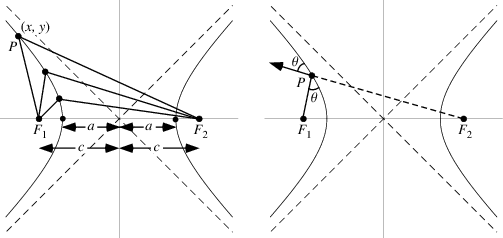

Why is it necessarily true that for a hyperbola, the focus length, ##f ## has got to be greater than the semi-major axis , ## a## - ## f >a ## ?
I needed to derive the cartesian equation of a hyperbola with centre at ## (\alpha,\beta) ## and foci along the ##\alpha - ## axis. using the definition that the difference between the distances to the two foci is a constant. After some algebra, I just got back the equation of an ellipse.
$$ \frac{(x-\alpha)^{2}}{a^{2}}+\frac{(y-\beta)^{2}}{a^{2}-f^{2}}=1 $$
Of course I realize that this is also the equation of a hyperbola, under the condition that ## f>a ## so that :
$$ \frac{(x-\alpha)^{2}}{a^{2}}-\frac{(y-\beta)^{2}}{a^{2}-f^{2}}=1 $$
But I'm stuck at proving that this condition is, in general true, just from the definition given.
Could someone give me a hint?
Thanks!

We just call shapes with f>a "hyperbola" and with f<a "ellipse", they get different names because they look so different. In particular, a hyperbola has solutions for arbitrarily large x and y, which means the two summands must have different signs, whereas they have the same sign for an ellipse.
Yes, sorry I did! So the definition of the hyperbola as being the locus where there is a constant difference between the distances to two foci is incomplete? I need to know that ## f>a ## on top - I can't prove that just from this definition?
f>a should follow from that requirement.
That's my difficulty, I don't know how to show that it must follow... :P
In full my working currently looks like this - I'll borrow this convenient wolfram diagram for the symbols. Although the diagrams show clearly that ## f>a ## I do not think I assume this in my calculation. I've dropped the shift in the centre of the co-ordinate system because it doesn't really matter and obscures the working. (so centre is now (0,0) not ##(\alpha, \beta ) ##

From above ,at ## y =0 \ , \ 2x =C ## By definition of the semi-major axis of the hyperbola, if ## y= 0 \implies x=a ##
$$ \therefore \frac{x^{2}}{a^{2}}+\frac{y^{2}}{a^{2}-f^{2}}=1 $$
But from here I can't see how to retrieve the minus sign.
Thanks!
If C>2f (which corresponds to f<a as 2a=C), you do not get any solution of your original equation. The squaring process fakes an additional solution which has a meaning for an ellipse, but not here.
