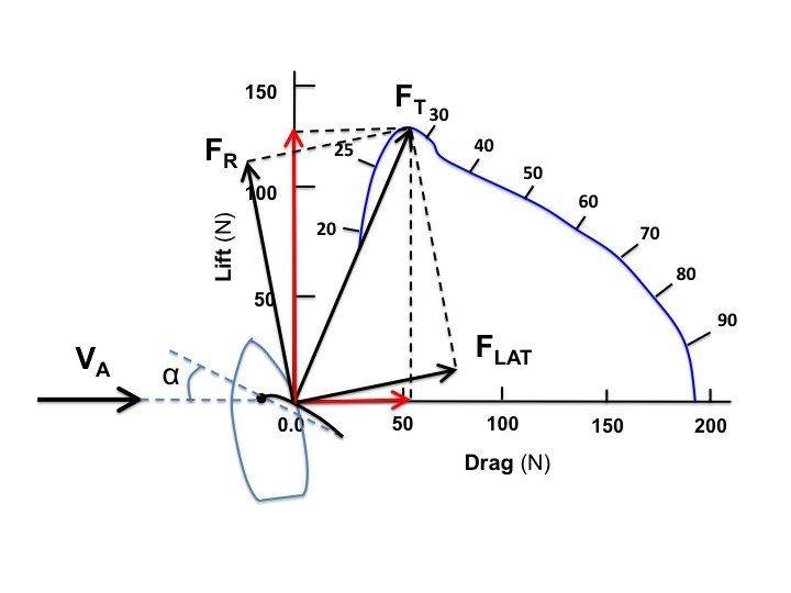

When sailing into the wind the lift creates a force on the sail that makes a cross section of the sail look like the Nike swoosh. For a given wind speed, sail size, and angle of attack, the equation of the slope should always look the same. I believe another assumption that needs to be made is the linear density of the sail, but I'm not sure.
I looked at the differential equation for a telephone wire hanging between two telephone polls and tried to equate the relationship of the shape of a sail this way.
One way I tried to do it was by showing the lift and drag vectors as two different forces acting at different angles. Another way was adding the Lift and Drag vectors and applying them at the combined angle.
So far I haven't been able to derive a differential equation that works.
What's bothering me is there is clearly a relationship which means there has to be an equation. Even if it's a messy one.
I can provide more information if you need it, but any insight with the information that I've already given would probably be the most beneficial.
Thanks in advance!

Thanks for the tips. I know it's very complicated. I've been up and down those references. I am trying to over simplify it and say that the cross section was unaffected by the top and bottom and that the tension was applied at the beginning and end. And then start making adjustments from there. I was thinking like how a telephone wire hangs between two polls, but if the polls were different heights.
That shape is called a catenary. I don't think it will help much in this case.
There is no simple formula. it is very complex. Just look at this one figure. You won't find a simple formula for that.
Considering the forces on a catenary all face the same direction and the forces on a sail rotate as they move about the sail should I scrap that idea? I thought I could use the combined force of drag and lift and equate that to the downward force of the catenary. It's quite possibly I have a conceptual misunderstanding.

The shape of a hanging uniform wire is called a catenary whose equation is well known. I do not think that this is related to a desirable shape for a sail since it is a symmetric curve and a sails profile is not. If you change the linear density of the wire you can change the shape and make it asymmetric but the curve will have a different equation although the technique for finding it would be the same as for the uniform wire. Sails are made usually of uniform density material and the panels are cut and sewn to produce a desirable shape.

It has been pointed out by @anorlunda that a sail is a very complex object. let me elaborate as I think it is instructive. A sail is a deformable surface whose shape depends on the tension produced by the lines attached to the sail. The proper shape of the sail also depends on wind velocity and angle of incidence at the front of the sail which changes appreciable you rise above the deck. It depends on the interaction with other sails. It depends on the shape and design of the hull of the boat. I depends. on the expected sea conditions. It depends on the stretchiness of the sail material and how it is oriented on the sail. Try to find a copy of "Sail Power" by Wallace Ross for a more detail explanation of traditional cloth sail making .
Most sail lofts today use some software to design sails. I think the simple programs are basically design on a semi empirical basis a combination of experience from centuries of building sails by hand and knowledge of the stresses within the sail that are required to best maintain the shape. More advanced programs can use wind tunnel simulations to produce a camber design appropriate for the boat and wind/sea conditions which is almost as good as you can get it.
Sails are still made the way they have been for centuries i.e., with panels of woven cloth sewn/glued together but they are increasingly made from laminated sheets of plastic film as Mylar in which strings of very strong fibers as Kevlar or carbon are laid along stress lines. North Sails is the originator of this process and uses a solid male mold to actually form the sail shape. These sail do not stretch very much and maintain their original designed shape much longer.
