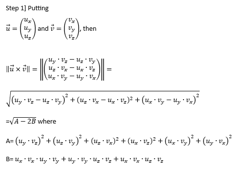

The two definitions of the magnitude ||u x v|| of a cross product, one via coordinates, and the other with uv.sin A, are obviously equivalent, but my brute-force attempt hits a snag.
In order to prove that two of the means to calculate the magnitude of an arbitrary cross product are equivalent, I tried a direct approach, which I outline below. Any hint as to where I am going wrong would be appreciated.
So I hope this is the right section-- although this may look like HW, it isn't. It is my own fumbling.

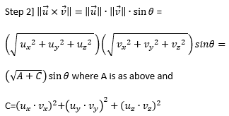

Then
Then,
Alas, this doesn't come out. What am I doing wrong? Some silly mistake, no doubt, but I would be very grateful to have it pointed out.
This isn't an arbitrary cross product if the second and third coordinates are the same.

Oops. Typo edited, thanks. Apart from that?

You carried that typo throughout the calculation. There is no 2B term in the cross product. The cross product is a Lie multiplication, hence the Jacobi identity holds, hence it has to be symmetric in (x,y,z) and the pairs (x,y), (y,z), (z,x) with a cyclic permutation.
Edit: Mistake corrected.

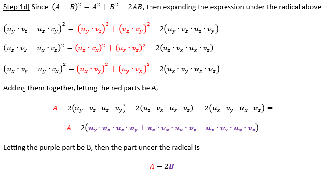

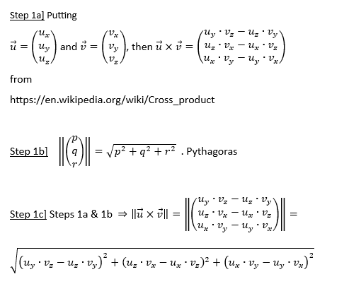

Thanks very much for your reply, fresh_42. Let me start with your remark that there should be no 2B (my notation) in the result.
To find out where my mistake appears, I have broken Step 1 into four sub-steps for easy reference.
After I have figured out where my mistake(s) is (are) here, I will comb my text for the typos o:) leading to the asymmetry you mentioned, as I don't see them at first glance. I will search again, but then I may turn to you again to specify. Thanks for your patience.
The essential point in your considerations is the sine of the angle between your vectors. How do you compute the sine without using the cross product? And turning it into a cosine doesn't answer the question, that's only adding confusion.
As I see it, you want to prove ##\sin \measuredangle (\vec{u},\vec{v})= \dfrac{|\vec{u}\times \vec{v}|}{|\vec{u}|\cdot |\vec{v}|}## where you have formulas for the right-hand side. So the question has to be: what is on the left? Do you use the law of cosines together with ##1=\cos^2\measuredangle (\vec{u},\vec{v})+\sin^2\measuredangle (\vec{u},\vec{v})## which is why you introduced the cosine? I guess, this can be done, even if it looks a bit like a nightmare of a calculation to me:
\begin{align*}
|(\vec{u}+\vec{v})^2|&=|\vec{u}|^2+|\vec{v}|^2-2|\vec{u}||\vec{v}|(1-\sin^2 \measuredangle (\vec{u},\vec{v}))\\
\sin^2 \measuredangle (\vec{u},\vec{v})&=1+\dfrac{|(\vec{u}+\vec{v})^2|-|\vec{u}|^2-|\vec{v}|^2}{2|\vec{u}||\vec{v}|}\\
&=\dfrac{|(\vec{u}+\vec{v})^2|-|\vec{u}|^2-|\vec{v}|^2+2|\vec{u}||\vec{v}|}{2|\vec{u}||\vec{v}|}\\
&=\dfrac{|(\vec{u}+\vec{v})^2|-(|\vec{u}|-|\vec{v}|)^2}{2|\vec{u}||\vec{v}|}\\
\sin \measuredangle (\vec{u},\vec{v})&=\sqrt{\left|\dfrac{|(\vec{u}+\vec{v})^2|-(|\vec{u}|-|\vec{v}|)^2}{2|\vec{u}||\vec{v}|}\right|}\\
\dfrac{|\vec{u}\times \vec{v}|}{|\vec{u}|\cdot |\vec{v}|}&\stackrel{!}{=}\sqrt{\left|\dfrac{|(\vec{u}+\vec{v})^2|-(|\vec{u}|-|\vec{v}|)^2}{2|\vec{u}||\vec{v}|}\right|}
\end{align*}
I didn't even use coordinates, yet, and I'm not sure whether I made a mistake or not. How do you plan to get through without any copy-and-paste errors?
If this wasn't your strategy, what else is it?

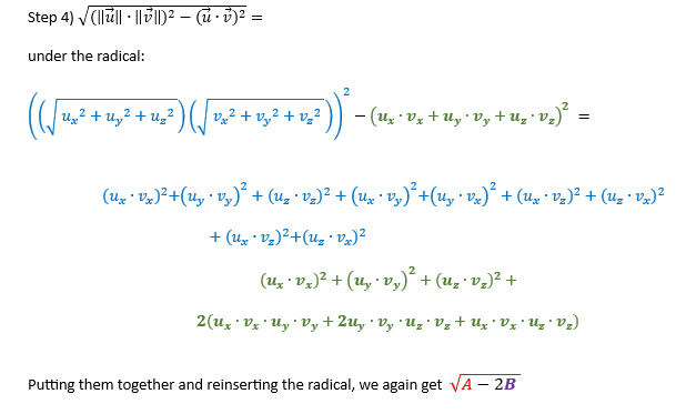

Thank you, fresh_42. First, I have downloaded the ArXiv article, which looks very useful. Second, yes, your calculations are essentially the direction I was going, although I was doing it more by brute force with the coordinates to show the two methods of calculating the cross product to be equivalent -- and in the meantime I found my error (which, as I suspected, was a silly arithmetic error). To be explicit, if you keep the Step 1 in my Posts #1 and #5 and then replace the other steps in the original Post #1 by the following Steps:
one gets the desired
So, thanks again for the help.
