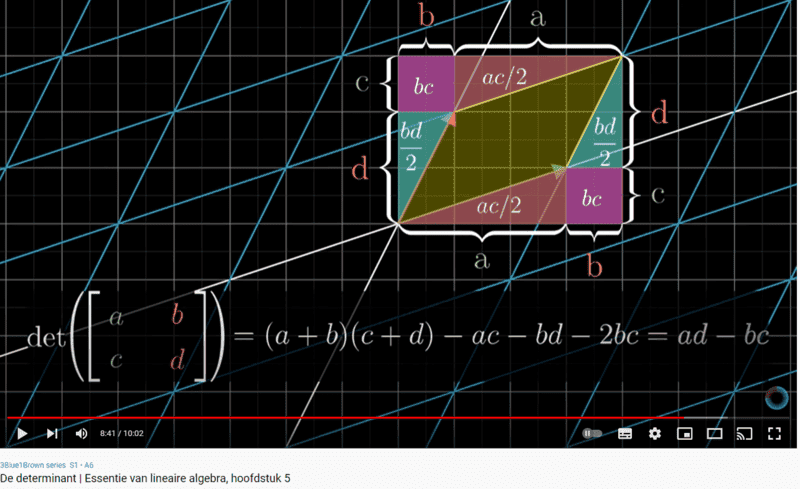

I think your answer is in this video:
But that video only speaks about the determinant. Unless I am confused as to the video (I could be), that does not mention (or reason) how the skew symmetric form of the first vector can be used to compute the cross product.
IT only mentions building BOTH vectors into ONE matrix, with the top row as the components: and I understand that.
I am looking for a "reasoning" as to why the skew symmetric form of the first vector can lead to the cross product. RIght now, I use my reasoning for the MOMENT of a force and the Trig rule for the cross product and then just say to myself: "the skew symmetric form implements THAT." And then I reason why THAT OLD Form gives the moment.

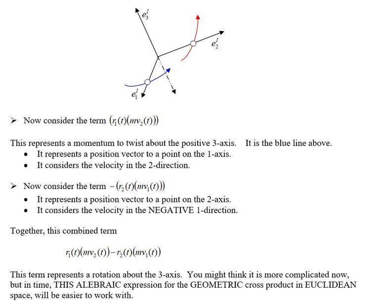

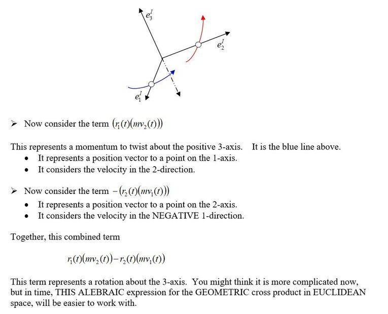

Here, I tried typing this picture. This is the best justification I can make.
It is a planar issue, but when I extend this reasoning to 3 dimensions I can "reason" my way as to why the skew symmetric form leads to an angular momentum.
But this is the best I can come up with. Has anyone reasoned out how "the skew symmetric form of the first vector's components, times the column of the second vector gives (this could be where my question confused everyone and I apologize for that -- previously I wrote "gives the cross product, but now I will write) "gives meaningful information."
