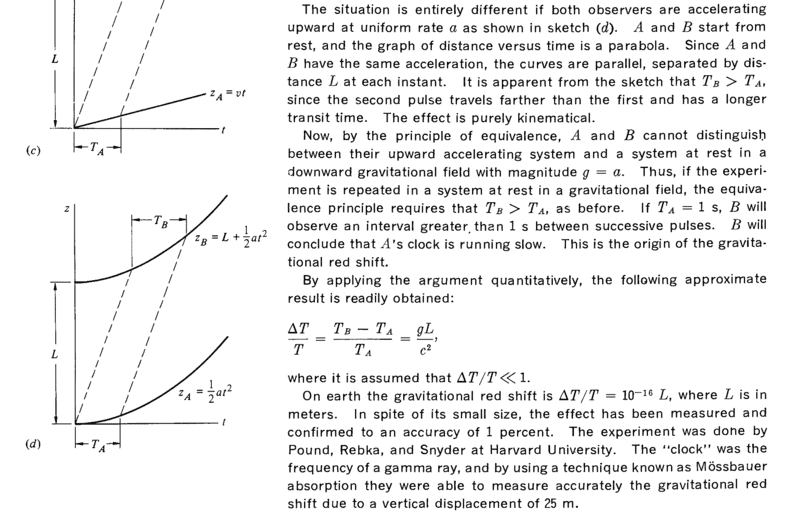

While reading "The Equivalence Principle and the Gravitational Red Shift" in the book (Introduction to Mechanic by Kolenkow & Kleppner) I'm having doubts about how they arrived at the result gL/(c^2).
They are treating the spacetime curve as a parabola, but is it a parabola?
And I think there is some serious conceptual error in the analysis.
please help me
Every differentiable curve is a parabola to 2nd order about any given point.
But what will be the actual curve in this case?
It is actually a hyperbola. However, that does not make the derivation wrong. It just makes the derivation a derivation to 2nd order. This is not a "conceptual error", it is a valid approximation.
Likes Ramanathan k s, PeterDonis, vanhees71 and 1 other person
It's still a somewhat hand-waving argument, but it's correct given the approximations made.

actually the result is $$\ 1+\frac{g h}{c^2}.$$
actually the result is ## 1+\frac{g h}{c^2}##
Can’t be, the ratio of frequencies has to be less than one for upwards-moving light to be redshifted.
Likes PeterDonis and vanhees71
I think my sign is correct, because for ##h>0## there must be red shift, because the "naive photon" looses energy moving "upwards".
