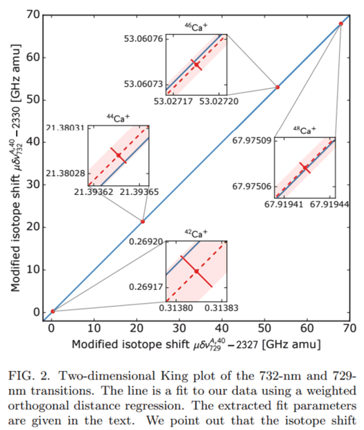

Figure 2 is what I want to fit to
That's not your data, that's their data. They have the orthogonal distance available in something that looks like a parity plot. Are you convinced that situation is the same in your data ? Can you show ?
I don't have access to thehttps://epubs.siam.org/doi/pdf/10.1137/0908085, but it seems a bit more general.

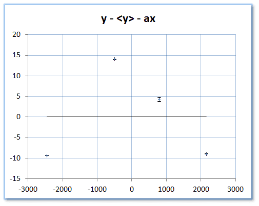

Here are some of my data points: y = [-508.89,531.11,1190.36,1888.80], error_y = [0.09,0.09,0.49,0.11], x = [-954.76, 1000.28, 2286.75, 3655.38], error_x = [0.11,0.12,0.39,0.20]. The errors are only statistical. As I said, I want to fit this with something of the form y=ax+b+f(x). Physically, f(x) contains new physics. Given the big error on the values I have, f(x) will (most probably) be consistent with zero. What I need to do is to find a 95% exclusion interval for f(x), something like f(x)<10−10 at 95% confidence level. This is what they do in Figure 3 in that paper. Basically this is what is done in literature (I can send you several other papers if it is useful). We measure these 2 values on the x and y, and try to set limits on f(x). The hope is that by reducing the errors on x and y at a point we would be able to actually see a deviation from linearity and set an actual value, not just a bound on f(x). Here is a paper which actually claims a 3σ deviation from linearity in exactly the same type of plot.

I did unweighted regression on four points ##y-<y>## vs ##x-<x>## and got 0.520 ##\pm## 0.004 as slope and 0 ##\pm## 7 as intercept -- you can do slightly better with N points. Thanks to the subtraction those errors are now uncorrelated.​
You have a model ##f(x)## which I suspect is discrete in both ##x## and ##y##. (I can barely read the isotope shift papers, let alone understand what's going on :cry: ). And you have N-2 degrees of freedom to fit features of ##f##.
At this point I'm stuck for I don't know if you can simulate the measurements by calculating a ##y## for every ##x_i## or not. If you can, the thing to minimize is ##\sum (y_i-y_{i,\text{calc}})^2## (if necessary weighted). But Murphy makes it likely you can't -- and then I don't know what to do with ## x_i-x_{i,\text{calc}} ##.

I was thinking about this more over night, and it dawned on me what the folks in the https://epubs.siam.org/doi/pdf/10.1137/0908085 are doing (I think!). I also don't have access, so this is a guess based on the abstract.
In the Solaro paper, there's a quote that stuck out at me (and they say this very emphatically):
We emphasize that ##\delta \nu_{732}^{A,40}## is deduced from measurements of ##\delta \nu_{729}^{A,40}## and ##\delta \nu_{DSIS}^{A,40}##, and that ##\delta \nu_{729}^{A,40} \gg \delta \nu_{DSIS}^{A,40}##. Consequently, the measurement uncertainties on ##\delta \nu_{729}^{A,40}## and ##\delta \nu_{DSIS}^{A,40}## translate into errors bars essentially parallel and perpendicular to the fitted line, illustrating that the analysis is limited nearly exclusively by the achieved accuracy on ##\delta \nu_{DSIS}^{A,40}##.
This makes their error analysis very unique. Not only do you have measurement errors, but the error on the y-axis is partially correlated with the error on the x axis. This means you can take all the cookbook rules for linear regression and chuck them right out the window.
What I believe Solaro et al. do (and this is a guess) is they have a non-linear fitting algorithm. I couldn't tell you exactly what the algorithm is, but I can tell you one algorithm that will do the job (perhaps not efficiently, but it gets the job done). This algorithm would be identical to Levenburg-Marquardt but with the linear regression replaced by Deming regression with ##\delta = 1## (aka orthogonal distance regression or ODR). They probably entered only the uncertainty ##\delta \nu_{DSIS}^{A,40}## into the algorithm, leaving out the uncertainty on ##\delta \nu_{729}^{A,40}## entirely. This is because, as discussed above, ##\delta \nu_{DSIS}^{A,40}## represents the error orthogonal to the line. I'm guessing the "weighting" that Solaro et al mentioned was inverse variance of ##\delta \nu_{DSIS}^{A,40}##.
The problem is, looking at your data's error bars, sometimes ##\sigma_x > \sigma_y## and sometimes ##\sigma_x < \sigma_y##, so clearly you measured these isotope shifts independently. If you had measured the shift between excited states like in the Solaro paper, we would expect to see something of the form ##\sigma_y = \sqrt{\sigma_x^2 + \sigma_{exc}^2}## where ##\sigma_{exc}## is the uncertainty on the isotope shift between excited states (##\delta \nu_{DSIS}^{A,40}## in Solaro et al). Since we see ##\sigma_y < \sigma_x## for some of your data, this cannot be the case.
However, I notice that for your data, ##\sigma_x \approx \sigma_y## at least within a factor of 2 or 3. So I believe you can still use nonlinear ODR but you will need to calculate the error perpendicular to the fitting line differently. I'm still pondering the right way to do that.
