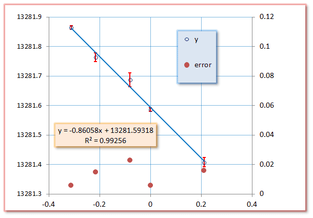

Here is the actual data. The fist column is the x-axis (the error is insignificantly low), the second column is the dependent variable and the third column the error on the measured value (the frequency). I need to plot the frequencies relative (differences) to the fourth one (13281.586) and fit a straight line to the differences vs x and extract the slope. My main question is what error should I quote on the 5 data points for the fit? Thank you!
-0.31240977 13281.864 0.006
-0.21655197 13281.764 0.015
-0.08060223 13281.687 0.023
0 13281.586 0.006
0.21088 13281.408 0.016
Good. So we are looking at this:
Excel (:oldruck: ) and I added a trendline without taking the individual errors into account (because I don't know how to coerce XL into doing that).
A linear fit is acceptable; assuming equal weights is disputable. (how come the errors vary so much?)
You can be the judge whether that is sensible -- if not, retreat to the formulas in post #2.
I see nothing suspicious in the data - but a sample size of 5 is of course not all that overwhelming.
Regression (equal weights, same reason as above :smile:) gives:
This would be for the fit as you describe it: wrt (0, 13281.586)
I would add 0.08 in quadrature with 0.043 x and take the square root. Then round off to one significant digit (two if the first is a 1).
You will also have to worry about systematic errors: the 0.08 is less than one in a million ! But that's physics, not statistics :wink:

Thank you for your reply! I am a bit confused as to why did you subtract the mean of the values. As we use the 4th point as the reference, shouldn't we subtract 13281.586? I assume that the value of the slope will be the same, as well as the error, but I was just curious why the mean?
[/QUOTE]
[/QUOTE]
I am not sure I understand this part. What error would be this? And where is the 0.08 coming from?
Do you know a little bit about simple error propagation ? If you have an estimate ##y = ax +b## with ##a\pm\sigma_a## and ##b\pm\sigma_b## from a fit and ##\sigma_a## and ##\sigma_b## are uncorrelated, then your best guess for the predicted ##y## is $$y = (ax +b) \pm \sqrt{\sigma_a^2\; x^2 +\sigma_b^2} $$
The 0.008 is the estimated standard deviation of the intercept (It says 0.0077, but the error is only ##\approx## 50% accurate with five points sample). This error is independent of the error in the slope when the origin is ##(x_{\sf average}, y_{\sf average})## . (I see I typed 0.08 and confused you, sorry)Caveat: as said, for a fit with individual weights you have to retreat to the expressions in #2.

and same for the intercept, but using this formula i get these values:
$$30.021878997654973 \pm 2.122516723462284\times10^{-5}$$
$$-0.00018113826319896513 \pm 8.394340792573846\times10^{-7}$$
The means value are not that bad, but looking at the error associated to them, they seem to be few thousands sigmas away from the true value. What am I doing wrong? How should I combing all the 10000 values into a single one and what error should I put on it? Also, why is the weighted average failing? Thank you!
kelly0303 said:
They look consistent with the input values, but now I am not sure how to combine all the 10000 estimates in a single final number.
Excellent work! I wouldn’t combine the estimates, I would just plot a histogram of the results and compare that to the histogram obtained with the other method.
kelly0303 said:
I fit this with a straight line and I get 10000 values for the slope and intercept.
Did you do a weighted least squares with a weighting determined by the errors?
Thanks for this! But just out of curiosity, assuming that these 10000 points come from (a lot of) different experiments, how would you combine them into one value with an error on it? Why does a weighted average gives such a bad result? (I am more interested for future cases where I'll actually have to do something similar)
Well, you don’t actually want to combine them at all. If you combine them then you will lose important information. What you want to do is plot them as a histogram and mark or compare the histogram to the known true value. The histogram will show you if there is any bias as well as the range and any skewness.
If you really want just a few numbers then the minimum I would boil it down to would be five: the mean (no weighting) and standard deviation the median, and the first and third quartiles
Oh I see. So when is using a weighted average a good idea? Using the standard deviation here works well, but in real life, I would probably have the values of the slope from 2-3 experiments. How would I quote a value and an error based on these 2-3 values (to use in theoretical calculations for example)? Thank you!
