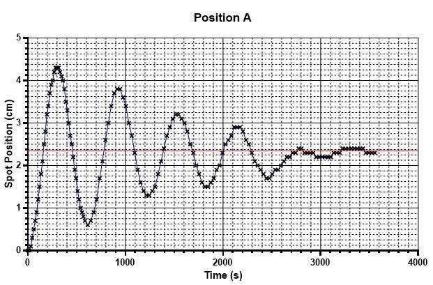

How can I estimate the decay coefficient in Ae^-at for this graph
Line graph titled Position A of spot position in cm against time in s, 0 to 4000 s, showing a damped oscillation that decays toward a horizontal red line near 2.3 cm.
I know the equilibrium position
damped oscillation
Table of time in seconds against amplitude in metres with rows for amplitude and decay coefficient alpha, followed by the formula alpha = -(1/t) ln(A_turn/A) and a worked example at t = 300 s giving alpha = 0.000575.
not sure if this is right.[/B]

This is right for the first 'period'.
If these are experimental data, you may take a mean value over all possible differences.
