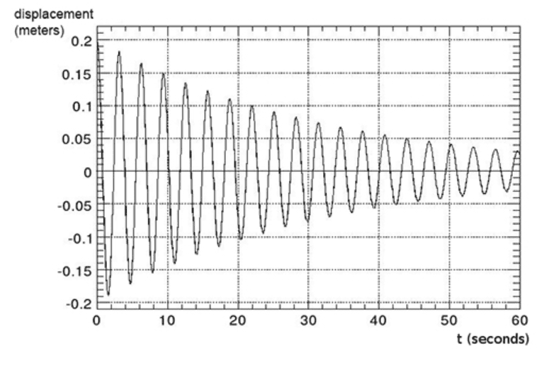

Using a force of ##4\text{N}##, a damped harmonic oscillator is displaced from equilibrium by ##0.2\text{m}##.
At ##t=0## it is released from rest. The resultant displacement of the oscillator from equilibrium as a function of time is displayed below.
Using the given information, estimate as best you can
a) mass of oscillator
b) quality factor of oscillator

At this point, we look at the given plot
My question is about estimating the parameters from this plot.
Recall that what we want to determine ultimately is the mass that is oscillating and the quality factor of the oscillator.

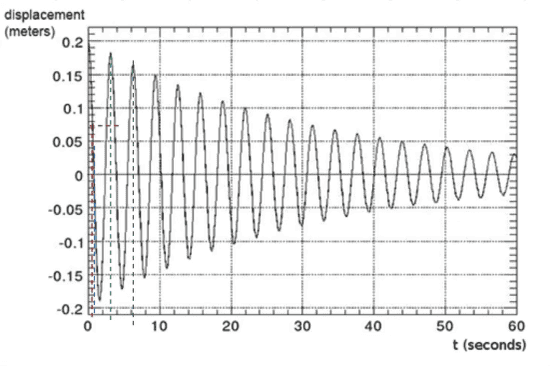

Suppose we try to estimate the pseudo-period from the plot.
I've drawn in some dashed lines in the plot to try to do this
The pseudo-period seems to be slightly larger than 3. Perhaps 3.2.

Here is an attempt to do this.
First, let's take a guess at what the (pseudo) period is. It looks like it is slightly more than 3. Let's guess
$$T\approx 3.2$$
This gives us
$$\omega=\frac{2\pi}{T}=1.96$$
Next, it looks like position is about 0.18 at time ##T##.
$$x(T)\approx 0.18$$
$$x(T)=e^{-\gamma T/2}A\cos{(2\pi-\phi)}=0.18$$
$$e^{-\gamma T/2}A\cos{\phi}=0.18$$
And using ##T=3.2## together with ##A\cos{\phi}=0.2## from previously we can solve for ##\gamma##
$$\gamma\approx 0.065$$

Remember the question asks you to ‘estimate’ – which suggests reasonable approximations can (should?) be made.
To find the period as accurately as possible, note that 19 oscillations occur in 60s. This gives ##T \approx 3.16## s. Don’t just use a couple of oscillations.
For reasonably lightly damped oscillations (as is the case here) a sensible approximation is ##\omega_D \approx \omega_0##. Using this makes finding ##m## simple.
If the decay factor is ##e^{{-\frac t{\tau}}}## then I believe a handy formula is ##Q = \dfrac {\tau \omega_0}2##. (To find ##\tau## use the graph to find the time taken for the amplitude to fall to ##\frac 1e## of its initial value.)
Avoid inappropriate use of significant figures, e.g. ‘##Q\approx 29.81##’ is an unjustifiable precision.

If you assume [itex]x(t) = Ae^{-\alpha t} \cos \beta t[/itex] then you will find [tex] \dot x(t) = Ae^{-\alpha t}(-\alpha \cos \beta t - \beta \sin \beta t)[/tex] so that if [itex]\dot x(0) = 0[/itex] then [itex]A \alpha = 0[/itex], which is a contradiction. If instead [itex]x(t) = Ae^{-\alpha t}\cos \beta (t-t_0)[/itex] then [tex] \dot x(t) = Ae^{-\alpha t} ( -\alpha \cos \beta(t - t_0) - \beta \sin \beta(t - t_0) ).[/tex] Thus if [itex]\dot x(0) = 0[/itex] it must follow that [tex] \alpha \cos \beta t_0 - \beta \sin \beta t_0 = 0[/tex] which implies [tex]t_0 = \frac 1 \beta \arctan\left( \frac \alpha \beta \right).[/tex]
[itex]\alpha[/itex] and [itex]\beta[/itex] can be directly estimated from the graph by considering the loss of amplitude over a period and the length of a period respectively. Then [itex]\gamma[/itex] and [itex]\omega_0[/itex] can be determined from [itex]\alpha[/itex] and [itex]\beta[/itex].
At [itex]t = 0[/itex] we must have [tex] 4\,\mathrm{N} = m|\ddot x(0)|[/tex] and we can easily find [itex]\ddot x(0)[/itex] in terms of [itex]\alpha[/itex] and [itex]\beta[/itex] by differentiation.
