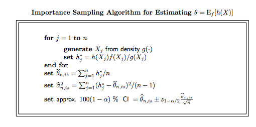

I agree and the idea makes sense in principle but I can't yet do it in practice. I am stuck on figuring out what is what with the expression $$\frac{e^{-(y-x)^2/2}e^{-3x}}{Z}$$.
I also don't know if I should try to simplify this analytically before running a simulation or just plug in each $X_i$ into $\displaystyle \hat{\theta}=\frac{1}{n} \sum_{i=1}^{n}\frac{f(X_i)g(X_i)}{h(X_i)}$ directly.
Here are the steps from the Columbia paper I'm reading. It seems they advocate directly plugging in each $X_i$ but again I don't know what my $h,f,g$ are.
I think I'll try working on another problem for a bit and come back to this to see if any new ideas stir.

As I understand it, you are supposed to evaluate the integral:
$$I \underset{def}{=} \int x \frac{\phi(x; 0.5) \epsilon(x; 3)}{Z}dx$$
where $\phi(x;y)$ is the pdf of the normal distribution with mean $y$, $\epsilon(x; \lambda)$ is pdf of the exponential distribution with parameter $\lambda$, and $Z$ is the normalization constant for the pdf in the numerator.Let's pick $f(x) = x$ and $g(x) = \frac{\phi(x; 0.5) \epsilon(x; 3)}{Z}$.
Then g(x) is a pdf, since it is normalized (integral of g(x) is 1).
So:
$$I = E_g[X] = E_g[f(X)] = E_\epsilon[f(X)g(X)/\epsilon(X; 3)] = E_\epsilon[X \cdot \phi(X;0.5)]$$
You can try to estimate it with the distribution $g(X)$, with the distribution $\epsilon(X, 3)$, or even with the distribution $\phi(x;0.5)$. One will probably be more accurate than another...

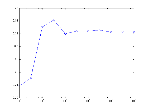

Final code (with a small optimization):
Code:
clear
n = round(10.^(1:0.5:6));
Z = exp(3)*(sqrt(2*pi)*(1-normcdf(2.5)));
for k=1:length(n)
    x = exprnd(1/3,1,n(k));
    r(k) = mean(x.*exp(-(0.5-x).^2/2))/(3*Z);
end
figure(2)
semilogx(n,r,'b-o')
(Clapping)
Well done ILS. You've taken a topic you hadn't seen before and had very poor guidance over from myself, and gave sound advice at every corner. I thank you again.
Just so you see here is the output of your code. It is 100% correct from everything I can tell. :)
Code:
clear
for k=1:length(n)
end
figure(2)
semilogx(n,r,'b-o')
Output:
Good!
And here's W|A's result, which is 0.322745.
It does seem to match. ;)
