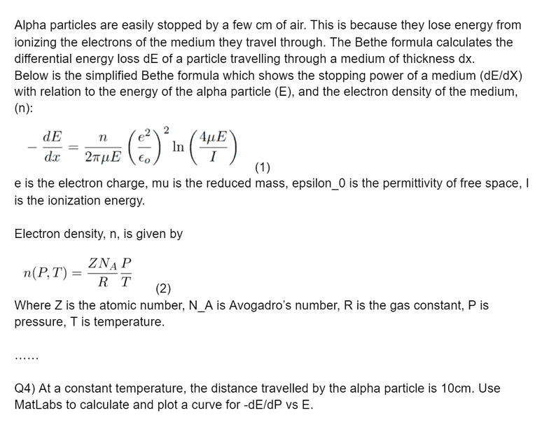

Full question is below
Bethe's formula
The question is below. I tried reasoning that because x is constant, E is also constant however that gives me values in the range of 10^51. Then I tried to use numpy's ivp_solve function to solve the differential equation however I wasn't able to get that working either. Apparently I'm meant to use Taylor's expansion to estimate E however I'm not sure how I would do that.

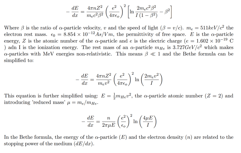

This is a simplified version which we were given because the alpha particle is non relativistic so beta << 1 and it also uses reduced mass mu and also E = 1/2 m_e/m_He.
This last statement is unclear. Please show what ## \mu ## is algebraically. Supposedly ## E ## is the energy of the alpha particle. This looks like a case where your notes that you might have taken in lecture contain errors.
This is what the question states
I have to admit, I can't make sense out of their asking for a graph of ## -\frac{dE}{dP} ## vs. ## E ##. Perhaps someone else can see what they are asking for here.

Are you 100% sure they are asking a graph of -dE/dP vs E?? I would be willing to bet that this is a typo and they really are just asking a plot of -dE/dx vs E, which is then simple, they just want the graph of the expression they provided. (By the way, their definition of reduced mass is very unorthodox!)

For instance, one might wish to choose a pressure where the response of the detector has particular characteristics for a certain energy alpha particle. Maybe there is a nice flat spot or an edge.
dE/dP makes no sense on its own. d2E/dPdx means something.
They were asking in the context of a 10cm path length so I assume that is the detector path length and an average energy if I recall
