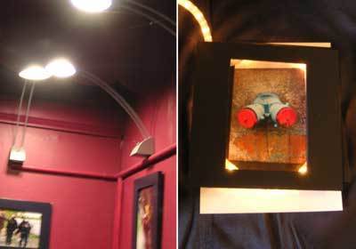

I want to light a half dozen pictures in 5x7 frames in a display in the corner of my living room (this display will likely be free-standing, like a privacy screen), but I don't want http://www.ikea.com.sg/products/product_display.asp?id=2237" . The room is somewhat dimly lit i.e. not enough to do justice to the pics.
I'm looking for lighting solutions. Maybe you guys'll think of something I didn't.
My two attempts so far (see attached file):
1] http://www.ikea.com.sg/products/product_display.asp?id=820" mounted near the ceiling, only one per column of pictures. Problem: lights dim with distance and obliquity.
2] Shadow box frames with 3' of rope light sandwiched between two mattes. Lights are now right next to picture but hidden behind a second matte. I love this solution! Problem: same, really - the string of lights are just not bright enough and are still too oblique. I'm also worried about the unevenness of the light from the rope. My next experiment will be to line the entire picture with white LEDs and see if it's enough light.
I'm open to suggestions.

  • Two photos side by side: left, a dark red-walled room with a ceiling-mounted light fixture and framed pictures on the wall; right, a framed picture in a black mat, backlit by a string of small lights along its edges.
Have you considered mounting high-intensity white LED's countersunk into the inner bottom edges of the frames? With diffuser lenses, they might provide a nice even illumination.

They make recessed lighting for just this purpose. The ones I have seen were small globes that could be rotated and did have a relatively small spread to the beam.
I have seen them like this that have the entire housing and a pivoting lamp:
http://www.lighting-fixtures-ceiling-fans.com/store/images/HALO_H1499IC.jpg
And I have seen these that are along the same lines, but without the large housing:
http://www.pegasusassociates.com/products/RecessedLighting/images/4itrimslowvolt/PNL-419-C.jpg
http://www.pegasusassociates.com/products/RecessedLighting/images/4itrimslowvolt/PNL-470-W%20-%20Adjustable.jpg

What is this diffuser lens thing? I'm thinking of trying some sort of prismatic lens to direct thet light onto the picture, but that'd be almost impossible to construct (and I'll need 32 sections!)
Hey, Dave. I just used 'diffuser lens' as a generic term to describe the effect. It can be a really thin layer of frosted glass/plastic, or even just a light coat of nail polish or varnish on the LED. The idea is just to 'fan' the light rather than having it more focused. The trick is to do it without a lot of transmission loss. Another trick is to angle the lights so they overlap in a criss-cross pattern to eliminate shadows.
