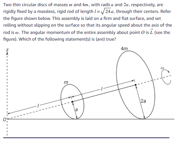

A diagram of a complex rigid body is given in the attached files having two discs of different sizes joined by a massless rod, statement of the question is given the picture in the attached files, I had doubt in one of the statements related to the rigid body given, that is its angular velocity of the center of mass of the whole system about z axis is w/5
for a point at a distance r from an axis of a rotating body , its velocity v=w x r
let point of contact of smaller disc with ground be P and
center of smaller disc be C and center of bigger disc be C'
angle POC= @
I assumed the angular velocity of the center of mass of the two discs about z axis to be w1
note that angular velocity of center of mass of both discs and center of anyone disc about z axis is same, you can verify that if you want, me after verifying it will use it to decrease the length of the my attempt section here
by applying Pythagoras theorem OP=5a, sin@=1/5
R=distance of center C from z axis = L*cos@, by some trigonometry
as the the discs are pure rolling on the ground, if we assume velocity of C of disc as V out of the plane of paper then the velocity of point P=V-wa=0( by condition for pure rolling)
V=wa
now by V=w1 x R
wa =w1 x L cos@
w1=5w/24
but the statement given further in the question that was cut out mentions the angular velocity about z axis as w/5
So I tried a more basic approach and got the answer , that approach is written further
if the the smaller disc rotates by angle 2pie in time t
then w= 2pie/t
t=2pie/w
as the smaller disc covers a circle of radius OP=5a for one rotation about the z axis, so the disc covers a circle of 2pie*5a
the smaller disc rotates by 2pie and covers distance 2pie*a for every complete turn, so it turns by 10 pie in one full rotation around z axis
in time 5*t so, w1 about z axis =2pie/5t
by this w1=w/5,
now i am in a dilemma why the first approach is wrong and the second one right?

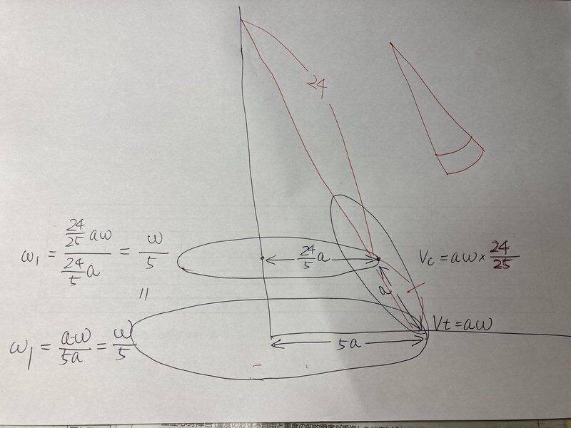

I see. To get speed of the center factor ##\frac{24}{25}## should be multiplied to speed of the tangential point. Slower because the wheel is inclined.
Handwritten geometry sketch of a tilted cone rolling on a horizontal plane, with a 24 label, distances 5a and 24/5 a, ω1 = ω/5 formulas, and Vc = aω × 24/25 and Vt = aω labels.

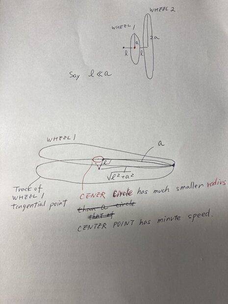

When a wheel goes on a straight line ##v_c=v_t=a\omega##. when perpendicular wheel go around it is also.
But when an inclined wheel goes round, Center with smaller radius and tangential points with larger radius go around in same T. It means center has smaller speed than the tangential point. See my sketch attached to the previous post.
Hand-drawn sketch of two wheels, Wheel 1 and Wheel 2, with Wheel 1 tilted; radii marked a and l, and the note 'Say l << a' above. Below, a tilted wheel traces an elliptical track with the labels a, l and sqrt(l^2+a^2), and handwritten notes 'CENTER circle has much smaller radius' and 'CENTER POINT has minute speed'.

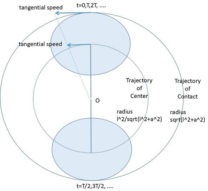

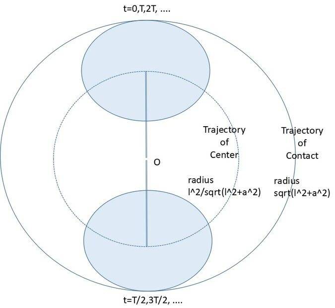

I do not catch your point but anyway tried to draw sketch of view from above. Is it alright ?
Diagram of a disk rolling inside a circular path, showing the disk's position at times t=0, T, 2T and at t=T/2, 3T/2, with the center trajectory dashed circle of radius l^2/sqrt(l^2+a^2) and the contact trajectory outer circle of radius sqrt(l^2+a^2).
Diagram from above of a disc rolling around a circle, showing two positions of the disc with tangential speed arrows, the centre O, and dashed and solid circular trajectories labelled Trajectory of Center and Trajectory of Contact, with radii l^2/sqrt(l^2+a^2) and sqrt(l^2+a^2).

center has smaller speed than tangential point , are you refferring to the the speed of the points on the rigid body barring rotation??, if yes then we were told in class that property of rigid body is that all points of a rigid body when considering translational motion have the same speed, your statement doesn't settle with this??

Nice diagram. But the effect is more obvious if you make the ellipse almost as big as the outer circle. As the ellipse rolls around the circle clockwise once, it only turns a fraction of a turn anticlockwise about its own centre.

Yes, it's like the lower diagram in post #10, but viewed from above.
Thanks. So in this diagram Center draws small circle in time T. Contact points draw large circle in same time T. Center has smaller tangential speed and Contact points has larger tangential speed. They have different linear tangential speed but same angular speed ##\omega_1=\frac{a}{\sqrt{l^2+a^2}}\omega##.
Here what do I miss your point or flaw of method 2 for exact ##\omega_1## you said in post#12 ?
