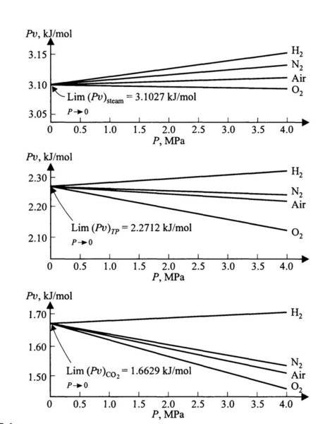

In the experimental virial equation for real gases,
Pv = A(1+BP) (for small values of P)
as 'P' approaches zero, then why do we get some finite value of 'Pv' instead of approaching to zero value, since 'Pv' is directly proportional to 'P' ?
{P = Pressure of gas, v = Molar volume of gas, A,B = Virial Constants}
Three line graphs of Pv in kJ/mol against P in MPa from 0 to 4, each with lines for H2, N2, Air and O2 extrapolated to P approaching 0; the intercepts are labelled 3.1027 kJ/mol for steam, 2.2712 kJ/mol for TP and 1.6629 kJ/mol for CO2.
  • Three line graphs of Pv in kJ/mol against P in MPa from 0 to 4, each with lines for H2, N2, Air and O2 extrapolated to P approaching 0; the intercepts are labelled 3.1027 kJ/mol for steam, 2.2712 kJ/mol for TP and 1.6629 kJ/mol for CO2.
At low pressure, gases behave more and more ideally. Boyle's law has ##PV = ## constant. A non-zero constant ! ##PV = n RT## in the ideal gas law .
At higher pressures you get deviations and the virial expansion is one way to introduce a correction.
Read up in e.g. Smith & van Ness: Chemical engineering thermodynamics
PS has your source some caption with the three figures ? What do they represent ?
