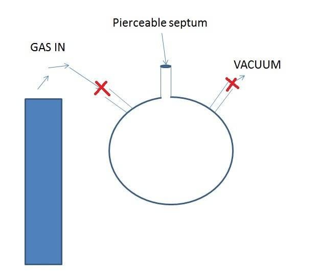

Hi, are there any experimentalists here? I have gas in a cylinder. I have just been taking samples of gas from a tube connected to the outlet, but air is getting in the syringe.
So I went over to chemistry and got a round bottom flask with 3 inlets / outlets and a septum, so its like this:
I evacuate the flask with the vacuum then flow the gas in, then after about a minute I pierce the septum with the GC syringe and take in some gas.
I am still getting air in the gas sample! Does anyone know a standard way of extracting gas from a cylinder (into a GC syringe) without air getting into it?
Any help would be really appreciated. I can order glassware etc etc but I don't know what specific equipment I need.

Hi, Many thanks for the detailed reply! Yes I have ordered some vacuum grease also I have got a couple of taps from chemistry, so it's like this:
I think the issue was that without the taps after turning off the vacuum the air was rushing back in! I will look into how to monitor the pressure / vacuum level in the flask, thanks! I can't use a laser as the sample needs to be injected into a gas chromatograph to calibrate the machine. Yes, a TC gauge sounds interesting, I will look into it! Thanks again!
Update, for those who have the same problem, this set up is working very well:
One goes to vacuum, other puts CO2 in.

To be honest we are low on funds and the above setup is working fine. We aren't really measuring the pressure levels (hence the film over the vessel incase it explodes / implodes) but its fairly safe, you just have to be careful when opening the blue taps (they are just air tight screw taps). The process is to close both taps, open vacuum (blue) tap, turn on vacuum, in less than 5 seconds the septum will become sucked in, close vacuum tap, turn off vacuum, turn on gas from cylinder, open (blue) gas VERY slightly and the septum blows up, close gas (blue) tap, turn off gas, repeat X 2... take sample from septum. It's not ideal, but when testing the gas by piercing the septum and injecting into the GC we are getting <1% air, in comparison to ~10-30% air just straight from a tube connected to the cylinder.
Big impovement for sure. 1% air would translate to a vacuum level of around 7 torr, close to the atmosphere of Mars:)
