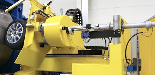

In a recent lecture,I learned that the friction coefficient "mu" between the tire and road surface is determined experimentally by using a graph. i.e a graph between the longitudinal tire force and the longitudinal slip. Well,how did engineers emperically arrive at such a graph in the first place?
I know that longitudinal slip is a function of the vehicle velocity and wheel longitudinal velocity.I guess it is easy to estimate. But,how could the longitudinal tire force be estimated? The lecture slides say that this could be made possible "... by measuring the tire profile deformation,from which the information of the potential transferred forces are determined." The connection on the relations is not quite clear.
Any ideas and experiences would be appreciated.
How does the tire deform?
Is there a material property that could relate the deformation to a force?
http://www.vmi-group.com/tire/products/tire-and-compound-testing/force-and-moment-testing/:
«The forces & moments acting on the tire are measured through a multi-channel strain gauge sensor mounted at the tire spindle.»

Since the stiffness of the tyre rubber material and the deformation(from experiment) are known,I guess one could calculate a force acting on the tyre. This force being longitudinal like a traction force is hard to imagine to me. I still don't quite know what equations they use to find the friction coefficient in the end.

It's not going to be a simple relationship... in practice, the calculations are done using a machine.
In principle it is much the same process as the exercise where you have a block of rubber sitting on a surface and you drag something across the top surface.
You also have to factor in "load range" since testing is usually done within the range on a "per tire" basis meaning that you could have two nearly identically tires show drastically different friction because one has a different load range and was tested with "more weight" against the friction surface.
