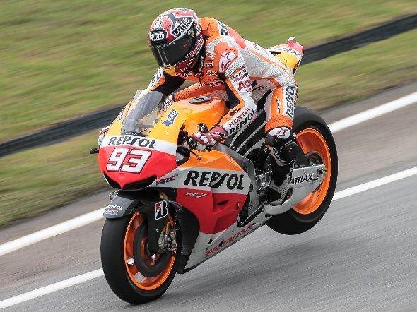

When cornering, racing motorcycles equiped with special tires (very soft and resilient rubber) can lean around 60° respect to vertical, which implies a practical coefficient of friction way over 1.0.
The area of the contact patches helps friction some, but not a lot.
I would call that bonus friction (besides the pure static type) “macroscopic grip”, as it is more instantaneous mechanical inter-lock of a semi-fluid rubber mimicking the macro irregularities and imperfections of the road surface than interaction at molecular level of the pure static friction.
That “macroscopic grip” varies much under the influence of the suspension movement and weight transfer during strong acceleration and braking.
The hysteresis is what forces a racer to be smooth on the controls, as the contact patches have certain reaction inertia, needing certain time to “adapt” to new loads and demands.
Grab the front brake handle suddenly and you go down inmediately after; apply gradual increasing pressure and the machine can do a “stoppie”.
That overall coefficient of friction is also dynamic; hence, irregularities or undulations of the surface, as well as camber of the road, combined with the speed of the bike and the response of the suspension mechanism is constantly changing both, the normal force and the area of contact.
The combination of flexible rubber, deformable carcass, rotating tire and lateral forces create a crabbing effect; therefore, the tire cannot follow the path that a rigid wheel would follow.
That is an additional twisting effect on the contact patch that makes it less complying with the roughness of the surface: less available traction when that is happening.
