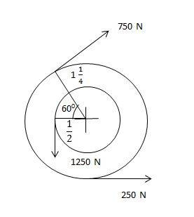

Determine completely the resultant of the forces acting on the step pulley shown in this figure
##M_{axle} = 250 (1.25) + 1250(0.5) − 750(1.25)##
244681
##R_{X} = \sum F_{X}##
##R_{X} = 750.sin 60^{0} + 250##
##R_{X} = 899.52 N## to the right.
##R_{y} = \sum F_{y}##
##R_{y} = 750.cos 60^{0} - 1250##
##R_{y} = - 875 N##
##R_{y} = 875 N ## downward
##R = \sqrt {R_{x}^{2} + R_{y}^{2}}##
##R = 1254.89 N##
## tan θ_{X} = \large \frac {R_{y}}{R_{x}}##
## tan θ_{X} = \large \frac {875}{899.52}##
##θ_{x} = 44.21^{0}##
##M_{axle} = \sum M_{center}##
##M_{axle} = 0##
Thus, ##R = 1254.89 N## downward to the right at ##θ_{x} = 44.21_{0}## and passes through the axle.

Explain why a negative sign is used before the 750(1.25)?

In the diagram, Force 750 is acting in north east direction, It's X component will be +ve. But why negative sign is used?
Because it wants to make the wheel turn in a clockwise -- mathematically negative -- direction
Does this help ?
Does this help ?
I thought clockwise means positive, so what makes clockwise direction is a negative thing?
The other two torques want to make the wheel turn counter-clockwise.
Regardless of whether we label clockwise as positive or negative, one torque still acts opposite to the other two.

Thus, ##R = 1254.89 N## downward to the right at ##θ_{x} = 44.21^{0}## and passes through the axle.
What is the meaning of "downward to the right "? Why not "upward to the right"? How to decide it?
Your words, not ours ... :smile:
I suppose you assume the axis of rotation is horizontal ...
'to he right' isn't so easily described :rolleyes: (but you took the 250 to be positive, so that's the +x direction)
My final answer is right or wrong?
Your answer appears correct to me.
However you should really start your answer by declaring that you define upwards, right and anticlockwise as positive. Don't leave it to convention or let the examiner guess.
Your answer for the resultant force has components
RX = 899.52N
RY = −875N
That means the resultant is to the right and downwards _because_ you defined up and right as positive.
As an exercise you could define downwards and left as positive. Then repeat all the equations and your answers then would be:
RX = -899.52N
RY = 875N
That would _still_ mean the resultant is to the right and downwards _because_ this time you defined downwards and left as positive.
