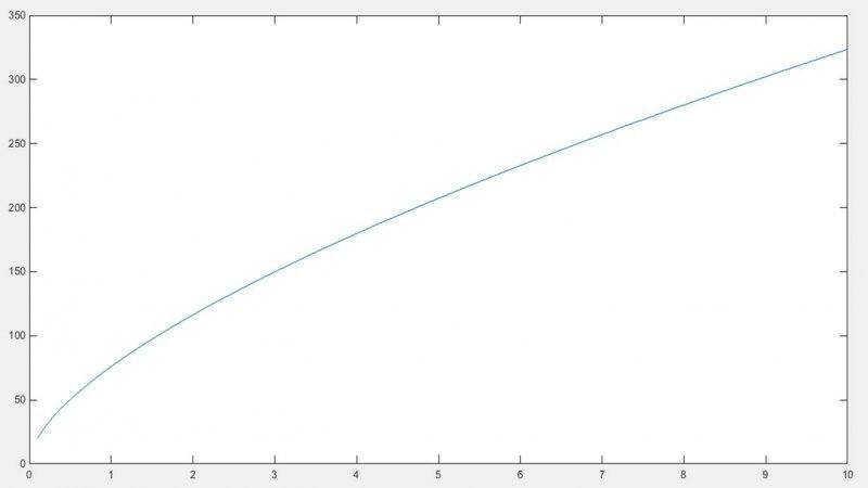

I have plot the solution to U(I) as according to the assignment. Please check solution1.jpeg to se my solution plot. I am very sure that my solution is correct.
The only question I have about this assignment is why the temperatures in the real model (I assumed that it is meant about the given differential equation) cannot be higher than the temperatures in the equation to be solved with Newton-Raphson's method and then plot U(I) for I=0.1,0.2,...,10 in the first assignment. I am not sure about how to explain this, so a little help here would be worth gold to me now.
Thanks in advance for helping me with this problem!

I have solved the latter equation by the help of Newton-Raphson's method for a every given I and I also plotted the solution just like shown in solution1.jpeg. I have also solved the differential equation with finite differences method and the highest temperature for a given I is somewhat smaller than the temperature for the same given I that is plotted according to solution1.jpeg after solving the equation with Newton-Raphson's method. So it is true that the temperatures in the differential equation for given I's are not bigger than the temperatures for same I's.
But I still not feeling that it gives me any ideas about why the temperatures in the equation (to be solved with Newton-Raphson's method) are bigger than the temperatures received from solving the differentil equation with finite differences method. I can see that when I solve the equation f(u)=0 with Newton-Raphson's method, then I do omit the thermal conductivity. What significance does the thermal conductivity have to the temperatures in this case? I'm unfortunately lost in this problem :/

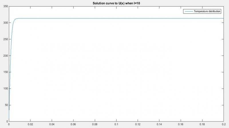

But let's take a little example: I have uploaded an image named pic1.jpg. It represents the solution curve to the differential equation when I=10. Compare the maximal temperature in pic1.jpg with solution1.jpg that was uploaded in the first post of this thread. As you can see, the maximal temperature in pic1.jpg is smaller than the maximal temperature for u when I=10 in solution.jpg. Can you see the small differences? How shall I explain why this thing happens. What is the reason to the fact that the maximal temperature in pic1.jpg is smaller than the temperature at I=10 in solution1.jpg? How would your answer somehow explain that? Want now put everything in relation to each other.

Not really, actually. The question, on which I would like to get answer on, is about why temperatures in the differential equation cannot be higher than the temperatures that has been received from the simplified equation. See my start post for further details about the question (the very last little paragraph) that is on the image labb41.jpeg and see thread post #24, where I illustrate an example about what I am talking about.
