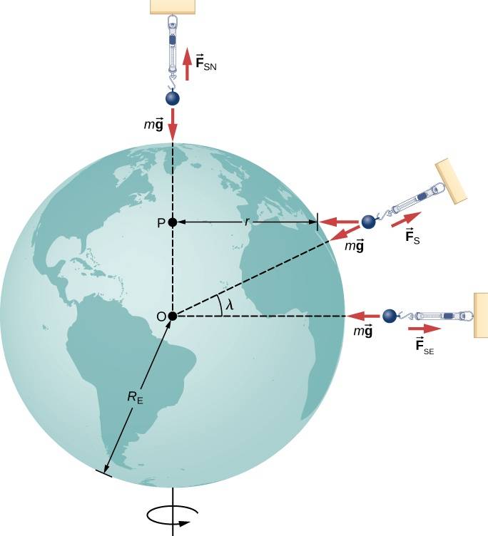

The apparent ##|\vec{g}|## at the equator, away from Earth's axis of rotation is lower.
I know how to calculate this difference of about ##0.03\ \frac{m}{s^2}##.
However, I do not intuitively understand this.
The closest I've come to an intuitive understanding: An object, whether it is on the ground or in vertical motion, is rotating away from Earth's gravitational inward pull at a small tangential speed that makes it feel like it has slightly reduced gravity acting on it.
Anyone got a better explanation or a link to a better explanation?

But, let's assume that there is a perfect spherical Earth that rotates perfectly on the north-south pole axis and has a rotation period of 24 hours and the same mass as earth. How do I intuitively understand the difference in apparent weight and gravity between the poles and the equator then?

An object at the equator is not moving in a straight line. In effect, it is constantly falling, accelerating at ##R\omega^2##. Thus, the upward force, i.e. the normal force (from the weighing machine), is less than mg.

In the picture that I posted above: on the pole, ##F_g = F_N## but near the equator ##F_g > F_N## (or ##F_N < F_g##). Is that correct?
It's not clear what you are asking because in the picture you posted above there is no ##F_g## or ##F_N##. Just look at the free body diagrams in Fig. 13.9 and consider the forces on the spring scale. At the Equator,$$F_{SE}-mg=-m\omega^2 R_E \rightarrow F_{SE}=mg-m\omega^2 R_E$$At the North pole $$F_{SN}=mg$$If we look at this in the rotating frame of the Earth, there is a centrifugal force at the Equator ##m\omega^2R_E## acting on the mass that reduces the reading on the spring scale relative to the weight ##mg##. In other words, at the Equator the spring scale measures the apparent weight of the mass. There is no centrifugal force at the poles so the spring scale measures the "true" weight, that is the force with which the Earth attracts the mass. The departure of the Earth from being spherical is a separate issue that affects the local value of ##g##.

Thank You @kuruman , you definitely cleared things up for me. I think I'll need to read up more on "centrifugal force" and "coriolis force".
