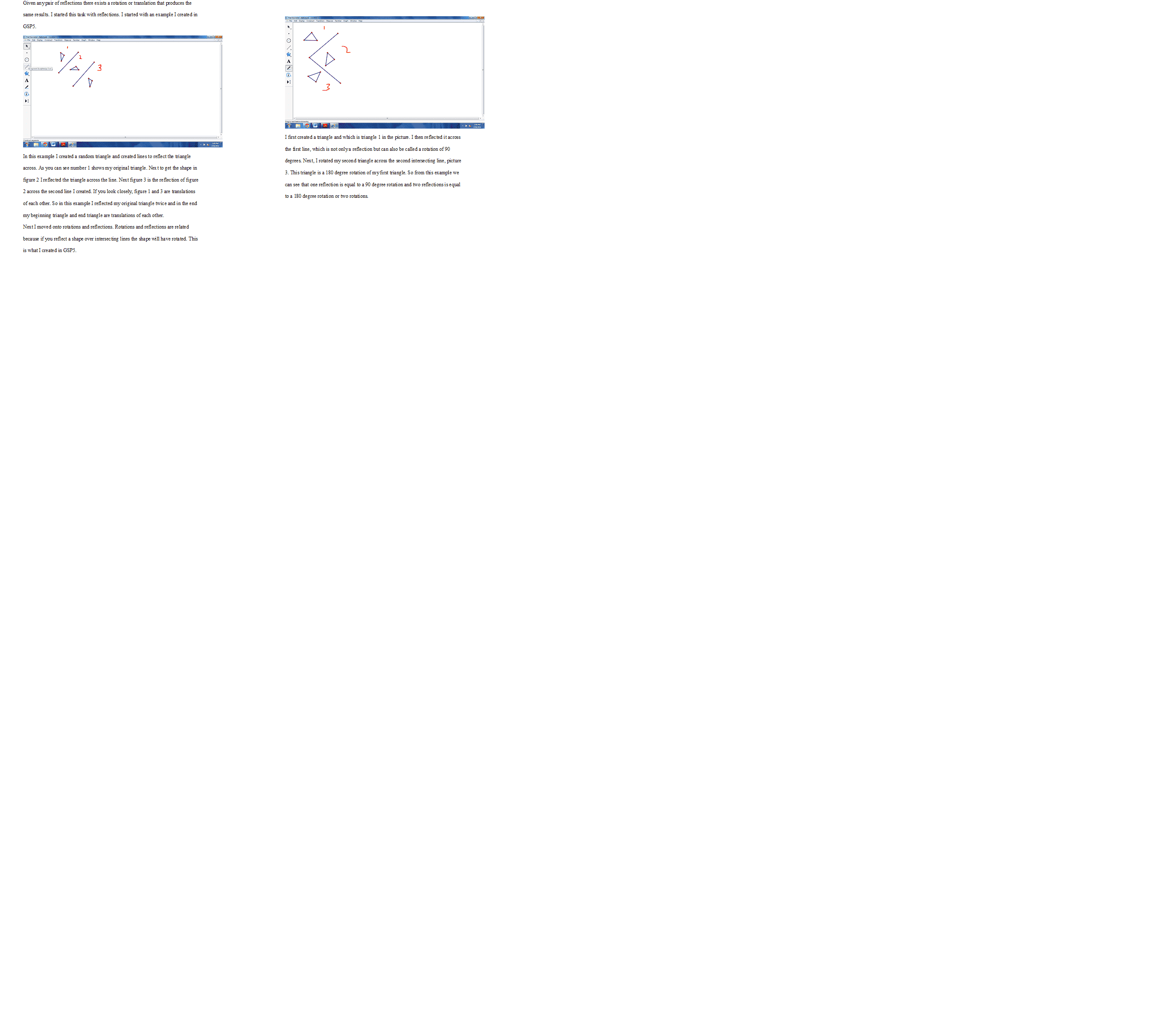

This is what I have come up with so far:This is what I have come up with so far:
Given any pair of reflections there exists a rotation or translation that produces the same results. I started this task with reflections. I started with an example I created in GSP5.
In this example I created a random triangle and created lines to reflect the triangle across. As you can see number 1 shows my original triangle. Next to get the shape in figure 2 I reflected the triangle across the line. Next figure 3 is the reflection of figure 2 across the second line I created. If you look closely, figure 1 and 3 are translations of each other. So in this example I reflected my original triangle twice and in the end my beginning triangle and end triangle are translations of each other.
Next I moved onto rotations and reflections. Rotations and reflections are related because if you reflect a shape over intersecting lines the shape will have rotated. This is what I created in GSP5.
I first created a triangle and which is triangle 1 in the picture. I then reflected it across the first line, which is not only a reflection but can also be called a rotation of 90 degrees. Next, I rotated my second triangle across the second intersecting line. This triangle is a 180 degree rotation of my first triangle. So from this example we can see that one reflection is equal to a 90 degree rotation and two reflections is equal to a 180 degree rotation or two rotations.
My mentor replied with these comments:
You need to discuss more about the translation scenario, in how two reflections in general will produce a translation. In other words, what relationship is there between the two reflection lines that results in a translation. In the rotation scenario, it is not true when you say this: “which is not only a reflection but can also be called a rotation of 90 degrees.” And again it is not true to say “we can see that one reflection is equal to a 90 degree rotation…or two rotations”. If you labeled your vertices of the triangles, you would see why these statements are not true.
As opposed to what?
Your mentor is correct. Imagine that a plane has two sides: red and blue, with red on top. If you perform a rotation or a translation, the red side is still on top. However, if you perform a reflection, blue side gets on top. If you perform two reflections, red side is again on top, which means that the composition of two reflections can be obtained without a reflection.
