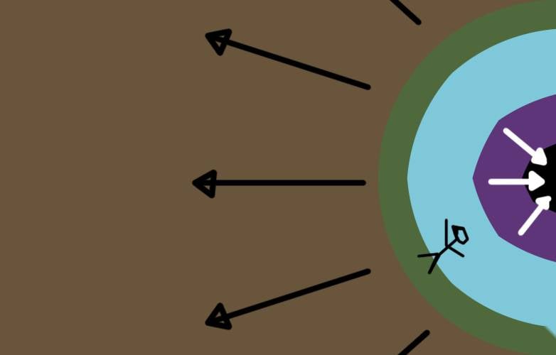

Hello everyone!
I am an undergraduate getting three bachelors in Anthropology/Ecology/Neurosciences (just to show off of course), but sadly no true physics (I don't show off that much, I'm still humble).
I am working on a personal project, a tabletop role playing game, where my main struggle is its main premises.
My world is a hollow Earth type world (yes I read the rules of this forum, this is just a RPG, and it's fantasy, nothing linked with the conspiracy, it just makes it interesting), and all I would like to ask is one question.
So imagine, their known and livable world is in a sphere, from which:
1, their "ground" is infinite in depth as it spreads away forever.
2, their center of the universe is the center of their sphere.
3, their "space" is first "empty", but gets denser and denser as it gets closer to the center of the sphere.
(Thus there is ultimately sphere in the sphere, where the "ground" is infinite, and the "space" is finite and small)
My question here is about gravity, and I would like to see if there is any possibility of it:
As the mass (to be defined) of their dense ground pulls everything towards the ground, and the mass (to be defined) of the universe gets denser at a certain point,
Could there be, depending of the defined masses of ground and space,
1, a livable environment where it would still be that of a normal gravity like on earth,
2, a zone in between ground and space where there would be no real forces (and/or they both get cancelled),
3, a place where the force from the dense "space" center of the sphere pulls objects.
And otherwise, if we removed the assumption #3 (just an empty space, no densification), could possiblities 1&2 happen?
Thanks to everyone for their time and attention, I look forward to your answers!
P.S.: I just made a fast sketch of the concept, just to broadly give the idea as it's quite far stretched.

Basically, you need non-Newtonian gravity (falling with distance faster than reverse-square rule)
Also, this forum may be not optimal place for such posts.
alternatehistory.com
for example have more discussions on world-building.
Huggas said:
...their dense ground pulls everything towards the ground...
That's not working this way. In this configuration as far as it is 'gravity' what is in effect there will be no gravity in the whole internal part at all.
Maybe you can give it a spin to create some artificial gravity: together with a real mass at the center it'll work ~ the way you described, but it'll has its own problems at the poles.

I see, thank you for your input.
Of course I am a neophyte in the domain of gravitational physics, and I thought that the formula for gravitational force depended on masses and radius.
Could you please explain me, briefly if possible, why there wouldn't be gravity inside the sphere, and whether having a dense center or an empty center would impact this.
Also, if "I give it a spin", where should the spin be, should the dense center be spinning, the whole sphere, or the ground, or everything altogether in different directions?
Lastly, if so, what are the problem you spoke about at the poles (the poles of the center or the whole sphere or both)?
To my first replier, how would non-Newtonian physics help this case, how this could happen?
Thank you so much!
Newton's shell Theorem shows that any point inside a hollow sphere whose walls are of uniform density (or infinite), gravity cancels out to zero everywhere inside.
A1 is twice as far from P as A2, but its area is squared. When you plug this into the formula for gravity, it turns out gravity pulls exactly the same in very direction, no matter where you are inside the sphere.
If you put a mass at the centre, objects will be attracted to it, exactly as if you were not inside a shell.
Spinning would produce artificial gravity, just like a space station.*
Rotating artificial gravity only works if you are rotating with the body. This means, if you can stop yourself from rotating with the body (i.e. counter spin), you will float without falling. unfortunately, you will be under a constant wind from antispinward, which will ultimately push you toward the ground.
* but how could you spin something whose diameter is infinite?
Magic.
This is already a fantasy - why does it need a rational explanation? Unless your players are actually going to solve the mystery of how the world works, they should be satisfied with it being hand waved.
Look up the 'Ringworld', that more or less describes the proposed situation within limits of acceptable science and it'll spare you a lot of questions.
Regarding the poles: it is about a different construct, a 'Dyson sphere'. The weakness of a Dyson sphere is that artificial gravity is proportional to the distance from the axle of rotation so it does not work around the poles (and it has the wrong direction everywhere else but around the equator). So this pole part of the construct must be strong enough to withstand the gravity of the center object. This problem does not apply for a 'Ringworld'.
