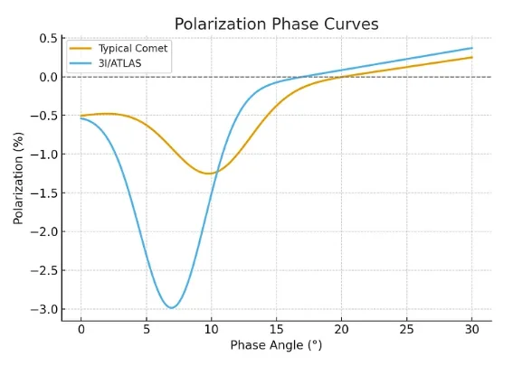

Line graph titled Polarization Phase Curves plotting Polarization (%) against Phase Angle (°) from 0 to 30; a yellow Typical Comet curve stays between about -0.5 and -1.25 then crosses 0 near 20, while a blue 3I/ATLAS curve dips to about -3.0 near 7 degrees and crosses 0 near 17 degrees.

To aid in understanding. About the paper description "reaching a minimum value of -2.7% at phase angle 7°, and an inversion angle of 17°". What is the minimum value, phase angle and inversion angle of a pair polarized sunglasses? I only know 90 degrees vertical and horizontal polarization description.

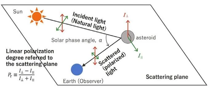

It's explained in the paper you linked:
https://iopscience.iop.org/article/10.3847/2041-8213/ae0c08 said:
The degree of linear polarization Pr of sunlight scattered by cometary dust particles is measured as the difference between the fluxes perpendicular and parallel to the scattering plane (Sun–comet–observer plane), normalized by their sum, and is highly sensitive to the solar phase angle α (Sun–comet–observer angle). Because of this definition, polarization is positive when the polarization direction is oriented perpendicular to the scattering plane, and negative when parallel.

Polarized sunglasses do not generate polarization by scattering, so you cannot apply the above defintion to them.
Light reflecting off any surface is usually partially polarised, either parallel or perpendicular to the scattering plane (the flat plane defined by the sun, the comet, and the camera). Negative polarisation means it's parallel to the plane, positive means perpendicular. The underlying cause is that how strong a reflection is depends on the angle of incidence of the light, but it depends differently for the polarisation parallel and perpendicular to the surface. So you get a changing mix of polarisations as the angle of the reflection varies.
So all the graph is showing you is how much difference in brightness you see when you put a polarising sheet in front of your camera parallel and perpendicular to the scattering plane, and how that varies as the phase angle (which I believe is the angle between the direction of travel of the incident and reflected light) varies. "Inversion angle" is the angle at which the polarisation sign switches. It's also very weakly polarised - less than 3% difference in the parallel and perpendicular fluxes.
The result tells you something about the surface roughness (for example, Titan does not have the negative polarisation dip that all other moons have because it has a thick atmosphere that reflects light, rather than a rocky surface), but you'd need to know more about polarimetry than I do to say anything helpful.

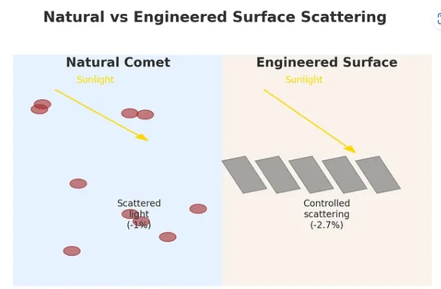

I tried to google illustrations about extreme negative polarizations. I couldn't find one where it is illustrated fully. I found one of these in the few images.
Side-by-side diagram titled Natural vs Engineered Surface Scattering: left panel shows a natural comet with sunlight arrow and scattered light at -1%, right panel shows five tilted grey plates with controlled scattering at -2.7%.

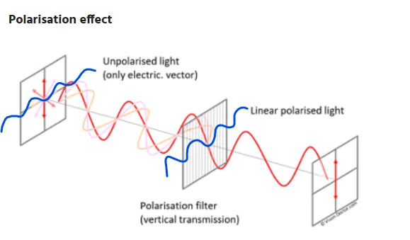

Let us go to the typical polarization example for my questions:
Diagram titled Polarisation effect: unpolarised light shown as a red wave with orthogonal electric vector components, passing through a polarisation filter marked vertical transmission, emerging as linearly polarised light with vertical arrows on a final plate.
When you mentioned "scattering plane". It is like the above plane of the source at left, correct? Now if extreme negative polarization means the light travels parallel to the scattering plane.. and I drew the blue waves depicting it. How can the light wave parallel to the source plane travels to the center. Does it? And does it mean all the light 100% is in the parallel plane?
If it does. Let's say the middle polarization filter doesn't allow any vertical component but only allow light parallel to the scattering plane (the blue) and the blue travels to the right. How can you see the light travelling parallel to the plane? Please draw visualization aid if you can because there is none in the entire internet. Many thanks.

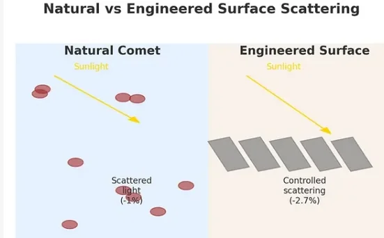

Diagram titled Natural vs Engineered Surface Scattering: left panel shows sunlight striking scattered reddish dots labelled Natural Comet, scattered light -1%; right panel shows sunlight striking five angled grey slabs labelled Engineered Surface, controlled scattering -2.7%.

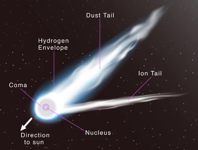

It doesn't appear like a normal comet which has dust tail like the following as the paper also emphasized at end of sentence in my first quote above.
Labeled diagram of a comet: bright round coma around a small nucleus, a hydrogen envelope, a dust tail and an ion tail extending away, with an arrow marked Direction to sun pointing toward the lower left.
