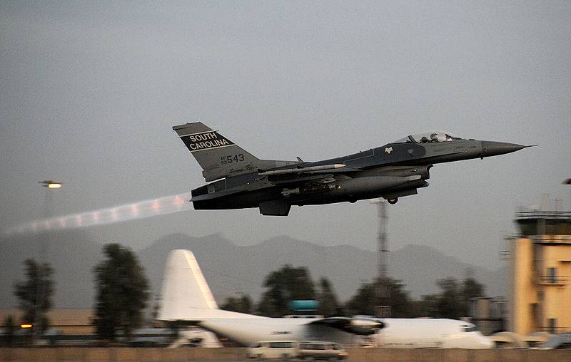

The F16 plane pictured generating "mach diamonds" is limited to mach 1.2 at sea level.
It certainly won't do mach 1.2 at sea level with a subsonic exhaust velocity considering it requires supersonic exhaust velocity to fly significantly slower.
I said I would pose the question to the guys next time I am at NASA and I will...but I can't be held responsible for their response.
