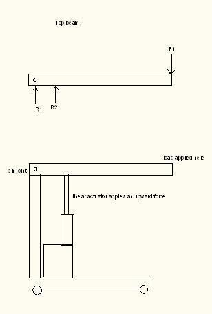

Hi guys,
I'm doing an assignment for college and designing a disabled hoist. I want to complete FBDs on the top beam especially. Can anyone help answer whether the work I've done is correct?

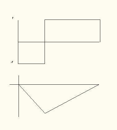

the equations I used were the sum of all force = 0
and for the bending stress that the shear force = dm/dx
Please see the two pictures attached for my attempts at (very quickly) drawing what i believe to be the correct solution. I'm taking the hwole thing to be static, as in the linear actuator is creating a force opposing the Load F. I would really appreciate some feedback, because I find F.B.D's hard to grasp, and I could be totally wrong!
Thanks
L
  • Free-body diagram of a horizontal top beam pinned at point O on the left, with downward load F1 at the right end and upward reactions R1 and R2 beneath, plus a side view of the hoist frame with a linear actuator applying an upward force.

  • Shear force diagram: a step plot with a level of F on the left portion, dropping to -F on the right, drawn against a horizontal axis with a vertical axis at the left.
What about the weight of the beam?
How would I incorporate w into a shear diagram? Would it effect it? I understand w is another force acting on the beam and will put it in the top FBD, but I don't know what to do for the Shear and bending diagrams.
Thanks
It's just another force. Treat it like you did the other forces.
