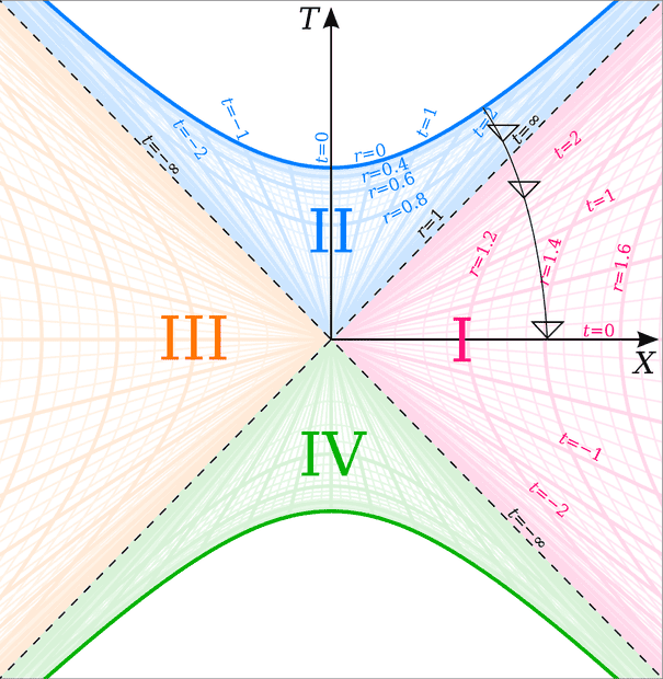

If, from an outsider's perspective it takes an infinite amount of time to cross the event horizon, but a finite amount of time for the black hole to evaporate, how does that look like from the perspective of the falling observer. For that matter, how does it look like from the perspective of the outside observer too? And how do black holes even grow from an outside observer's perspective anyway?
I feel like there's a major disconnect somewhere here, but none of the pop-sci I've seen on youtube has ever prepared me for this conundrum.
This isn’t true. Since the “if” is false none of the “then” applies.
This isn't really correct. It's a result of taking the Schwarzschild time coordinate literally, which is a mistake similar to deciding you can't walk through the North Pole because that's the edge of the map. It's perfectly possible to construct definitions of "simultaneity" so that the infaller crosses in finite time, but it requires a bit more maths.
They fall in in finite time and, classically, hit the singularity very shortly after. The latter part may not be correct (it probably isn't, actually), but since we don't have a working theory of quantum gravity we don't actually know what happens.

@Nugatory Could you link to one. Without knowing how to read one I can't seem to find one simple enough to parse.
martix said:
Well, the quality and accuracy of YouTube videos is highly variable. That's why we recommend reliable sources like textbooks. YouTube was invented so people could share videos of the cute thing their cat did.
You might try this one: https://en.m.wikipedia.org/wiki/File:Kruskal_diagram_of_Schwarzschild_chart.svg
All of spacetime outside of the black hole is in quadrant I. At any point in that quadrant, moving up the page is moving forward in time, moving sideways is moving either towards or away from the black hole (with only two dimensions in our diagram there’s no way of showing east/west or north/south motion so we’ll consider only radial motion).
The scale is chosen so that a flash of light will follow a path along a 45-degree angle: one light-second sideways for every second upwards. (If you’re familiar with the Minkowski spacetime diagrams of special relativity, this is the same concept). Anything moving at less than the speed of light (which is to say everything, including someone falling into the black hole) will follow a path steeper than 45 degrees: less than one light-second sideways for every second forward in time.
The hyperbolas labeled ##r=1.2##, ##r=1.4## and so forth are the paths of objects hovering at a constant height above the black hole. They are hyperbolas instead of straight vertical lines because of the curvature of spacetime, analogous to the way that the straight line path of an airliner appears as a great circle on a two-dimensional map of the earth.
The dashed line is the event horizon, so everything in quadrant II is inside the black hole. The blue hyperbola in that quadrant represents the singularity at ##r=0##.
The squiggly black line with the triangles is the path of someone falling into the black hole.
Once inside the event horizon, everything (including light following 45 degree paths) must eventually reach the singularity.
Light emitted at the horizon stays there forever; anything else on a path at a steeper angle must eventually reach the singularity.

@Nugatory Thanks for linking this.
In quadrant II, what is the interpretation of the constant 'r' curves? The infalling particle path looks to my eye close to perpendicular to these curves. Are these curves just for reference (as opposed to potential allowed paths for a particle)?
It looks like the triangle path crosses the EH at t = infinity and then counts down - is that how one reads this? If so, what are the implications of time starting at infinity and counting down in quadrant II, after having counted up to infinity on its way to the EH in quadrant I?
They are best viewed as moments of time that the infalling particle passes through between the horizon and the singularity.
In quadrant II the ##r## coordinate is timelike, so curves of constant ##r## are at less than a 45-degree angle and as @PeterDonis says should be interpreted as moments in time instead of points in space. Meanwhile curves of constant Schwarzchild ##t## are straight lines with slope greater than 45 degrees so are possible paths for an infalling object. (This is the basis for the common misstatement that “inside the event horizon time and space switch places”).
What’s really going on is that we cannot smoothly extend the Schwarzschild coordinates across the horizon because of the coordinate singularity there, so the ##r## and ##t## in quadrant II are different from the ##r## and ##t## in quadrant I, even if they’re represented by the same letters. It would make more sense to use different letters; see for example “Remark 1” on page 5 of https://arxiv.org/abs/0804.3619.
Is the following question purely a choice of co-ordinates, or is there some physics involved? Sorry to get so "meta", asking a question about my question, but after a few attempts that were much more wordy this was the shortest way I could think to ask.
Is it possible for the depicted object with some physically allowed acceleration to take, for instance, the t=2 path directly to the singularity after intersecting it? So I mean fire rockets at t=2 and given strong enough rockets experience no further 'time' (aging?) before encountering the singularity?
Edit: I am not ignoring the discussions around r being the timelike co-ordinate on this side of the EH, I am making the assumption that a traveler continues to experience time and aging for as long as they remain alive even after crossing the EH.
The Kruskal diagram deliberately has the same property as the Minkowski diagram that light travels on 45° lines. All timelike paths are closer to vertical. Inside the black hole you can travel on lines of constant Schwarzschild ##t##, but that's only because ##t## is a misnomer there - it's not a timelike coordinate inside the horizon. You continue to age as normal.
You can accelerate inside the hole. The strategy that maximises your survival time is to match speeds with an object that fell in from rest at infinity (IIRC), then freefall. Any other approach has a shorter proper time to the singularity.

Thank you for this explanation. I have yet to parse it fully, but let's start somewhere. I am wondering whether this diagram can finally make me understand the nature of gravity as spacetime curvature rather than a force.
So, in Minkowski spacetime (aka flat spacetime?) an unmoving object's worldline is just a straight line going up - only changes in time, not in space.
But let's put a gravitating object in the vicinity, which will give us a space-time like you see in a Kruskal diagram. Then the same straight worldline will instead take us closer to the gravitating object, because of the curved spacetime, which is effectively what gravity is.
Is that reasonable?
(You say the squiggly triangle line is an infalling object, and it's curved, so I'm not sure how that fits in, nor am I sure what an inertial or non-inertial frame of reference looks in this context.)

Sorry if the answer is in the paper that @Nugatory linked, I have it printed but haven't read it yet.
In what sense is it less confusing to call that co-ordinate the 't' co-ordinate? What is the motivation for that naming convention? Does it make equations on either side of the EH look more similar to each other?
I'm sure it makes sense to folks who learn the math, and the primary motivation for GR math in general is certainly not to make the topic convenient for parlor discussion. :-p

The squiggles just indicate that the infalling object is occasionally accelerating/decelerating, which is to say changing its speed, which is to say changing the angle of its worldline. If the infaller was free-falling, its path would be perpendicular to curves of constant ##r## everywhere and would look like a smooth curve instead of squiggles. I expect that the original author of this diagram added the squiggles to reinforce the point that no matter what the infaller does, even firing arbitrarily powerful thrusters to resist their fall, there is no escaping the singularity in their future.
I'm confused now. Which squiggle are we talking about now? The one with the triangles? If the dashed diagonal line is the event horizon arbitrarily powerful thrusters can always save you, right? As long as you're still in quadrant I.
It's curved towards the black hole, so to me it looks like the infaller is firing their thrusters to help, rather than counteract gravity. I imagine doing nothing would be a straight line up (i.e. similar idea to the video) and trying to counteract the gravity of the black hole would be a line curving towards the right.
P.S. t=∞ again rears its head, making the Kruskal diagram, if anything, reinforce what started all this, about never crossing the event horizon.
Well, if you don't mind being in a very thin layer across the back wall of your ship, yes.
The black line on the Wikipedia image looks like a freefall path to me, although you'd need to do a calculation to be sure. The hyperbolae in region I are the paths of objects hovering at constant ##r##. Anything that isn't curving to the right at least that much is falling in.
Sorry, yes, I was talking about quadrant II.
I suddenly feel like I'm wasting everyone's time. There's literally a similar thread from a week ago... I guess we might have seen the same video. (Well thank you everyone for humoring me.)
Anyway
The black squiggle looks smooth to me.
And does that mean a free-falling object would have an even greater curve to the left? Honestly, I'm having difficulty visualizing what a free-fall curve would look like on that diagram (I thought it was a straight line up - like in the linked video).
