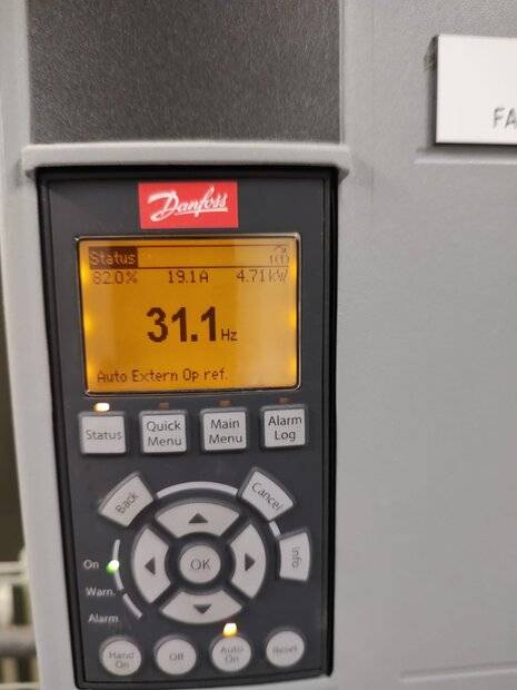

... it's not that easy to show pictures of bearings and couplings since the place has to go in shutdown to turn the fan off. (It runs on 30 Hz now)

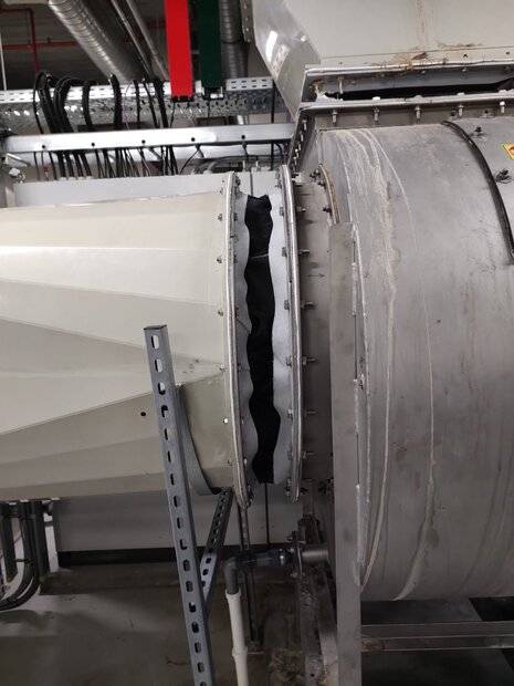

One of your pictures seem to show a solid bridge by-passing the isolation of duct-fan provided by the canvas connection.

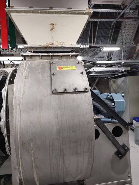

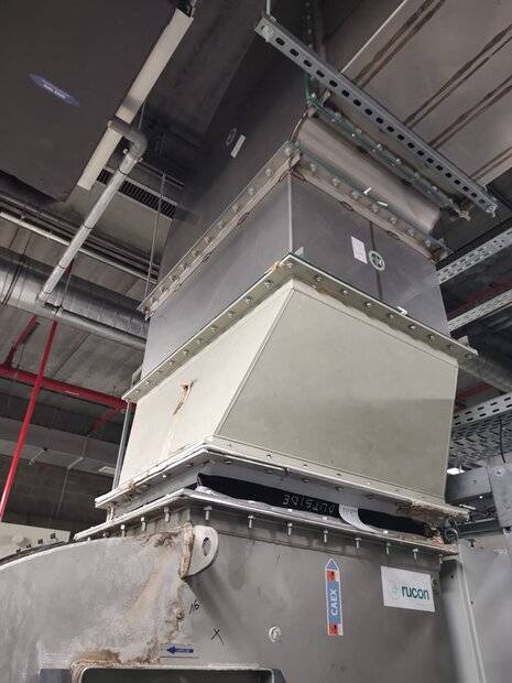

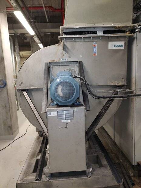

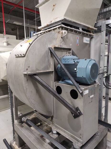

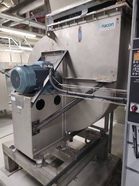

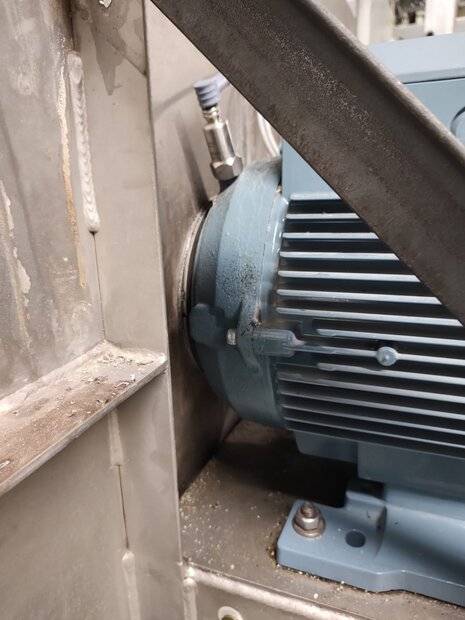

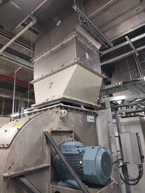

I'm sorry for the late answer. I've been on a holiday. I've went and took some pictures of the entire unit to maybe get you a better idea.
  • Large stainless steel centrifugal fan housing on a steel frame, with a blue electric motor mounted on its side and diagonal steel braces supporting the motor.

  • Industrial centrifugal fan with a grey sheet-metal housing and a large blue electric motor mounted beneath it, with a tapered white duct section and ductwork running overhead in a plant building.

  • Photo of a grey industrial electric motor with finned housing mounted on a steel base plate beside a metal enclosure wall, with a small pressure fitting visible at the top left.

  • Photo of an industrial fan installation: a white rectangular duct flange joins a large cylindrical grey metal fan housing, with a black flexible canvas connector bridging the two flanges and steel support framing below.

  • Industrial centrifugal fan with a stainless steel casing on a steel base frame, driven by a blue electric motor mounted on top, with a cable tray and a control panel at right.

  • Photo of an industrial fan housing with a tapered white-grey duct section mounted on a larger grey base unit, with a Rucon label and a Calix label visible, under exposed ceiling pipes and cable trays.

Based on Video #2 in Post #17, it appears that the blower housing has a mechanical vibration at 18.2 Hz. Mechanical vibrations are analyzed as spring - mass systems. The mass in this system is the blower housing, the spring is the side of the housing in the photos, and the motor base is fixed. That's why the request for the test in Post #27. Sometimes, your fingers are all the test equipment that you need. This might be one of those times, but you need to run the test to find out.
If so, the remedy is simple. Weld on a pair of stiffeners as shown by the heavy black lines in the image below.
Photo of an industrial centrifugal fan with a stainless steel scroll housing, an inlet hopper on top, and a blue electric motor mounted on a side bracket. Two black lines are drawn over the housing side.
You can leave the angled braces where they are, or make new ones that connect the same location on the base to the top of the stiffeners.
The theory is as follows: Natural frequency = ##\sqrt{\left( \frac K M \right)}##, where:
K = Stiffness
M = Mass
Since we want to increase natural frequency from 18 Hz to a value above the maximum operating speed of 30(?) Hz, it is necessary to increase the ratio of K to M by about a factor of 4. Reducing the vibrating mass that much is not practical, but it is practical to increase the stiffness. The stiffness of a thin plate is very low, and it is easy to increase that stiffness by a factor of several times by adding the stiffeners shown.

I'm assuming your s.p. was too high, which was why it is currently being run at 1086 rpm? Or is it the vibrations just passing through 1086 rpm on the way to 1470 rpm the issue?
