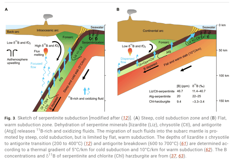

Here is a recent article (behind Science paywall) that describes two kinds of subduction zones with fast and slow sinking subducting plates. The difference seems due to the relative temperature of plates and their surroundings. This results in a density difference and therefore drive different rates of sinking.
Two cross-section diagrams of subduction zones, A steep and cold and B flat and warm, showing serpentinite dehydration, fluid flow into the mantle wedge and a table of boron concentrations and isotope values.
There could well be a variety of forces acting on plates in different ways.
