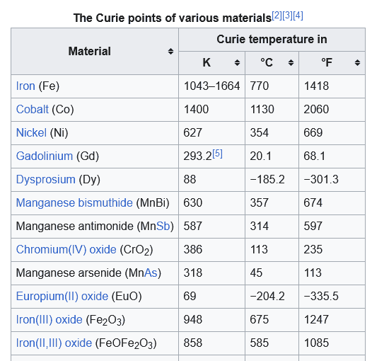

Hello everyone,I would like to open a debate on the possibility of designing permanent magnets whose Curie temperature (Tc) is as close as possible to room temperature, without compromising the intensity of the magnetic field. The goal is to find an optimal balance between a ‘low’ Tc and maintaining powerful magnetic properties.
Is there a viable research window in this sense? Could alloys and/or new manufacturing processes be used to precisely adjust the Tc? I am particularly interested in the following aspects
* Synthesis of materials capable of maintaining a high magnetic moment at a Tc close to room temperature.
* Structural modifications (doping, thermal or mechanical treatments) that control the ferromagnetic-paramagnetic transition.
* Recent or emerging lines of research into alloys with unconventional elements and advanced characterisation methods (e.g. neutron spectroscopy, high-resolution microscopy, etc.).
* Potential applications in which this property could have a major impact (sensors, actuators, biomedical devices, etc.).
I would particularly appreciate the opinion of those working in the engineering of magnetic materials, characterisation and design of advanced magnets. Where would you advise starting? What limitations or challenges do you see in the short and medium term? Thank you for sharing your experience!

Interesting question. What have you found so far in your searching on the subject? What have you found so far about things that affect the Curie temperature of different materials?
https://en.wikipedia.org/wiki/Curie_temperature
From that article, it looks like there is one material that has a ##T_c## of 20.1C (there you go!) and one at 45C. What is special about those materials? :wink:
One will wish to read
J.M.D.Coey, Perspective and Prospects for Rare Earth Permanent Magnets
Engineering 6 (2020) 119–131
https://doi.org/10.1016/j.eng.2018.11.034
Rare Earth Permanent Magnets—Review
