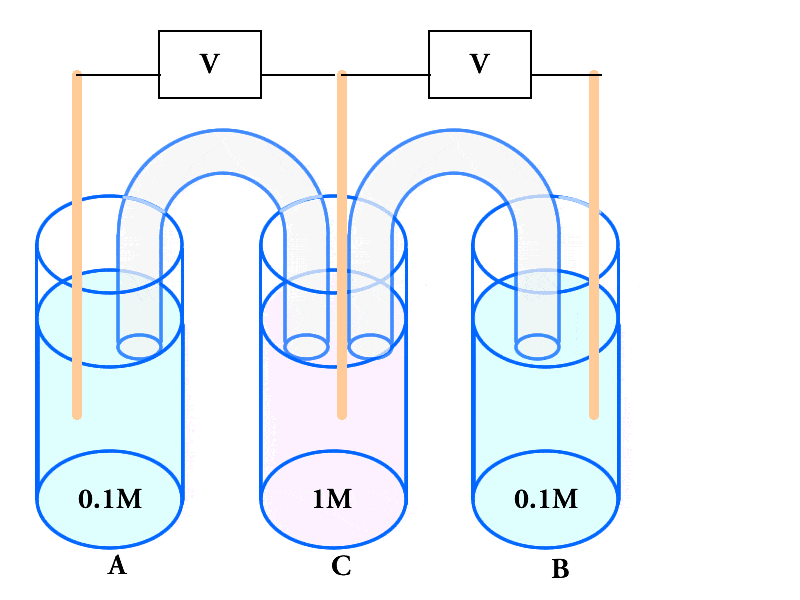

Another question:
Let's take 3 vats:
1/ The first (A) contains a copper sulfate solute at 0.1 M and a copper electrode.
2/ The second(B) contains a copper sulfate solute at 0.1 M and a copper electrode.
3/ The third (C) contains a copper sulfate solute at 1 M and a copper electrode.
They are connected by salt bridges A to C and B to C.
And with voltmeters by A to C and a second voltmeter B to C.
Is the voltage of each voltmeter a fraction (1/2) of the equilibrium voltage of my first example (the voltage is divided by the number of vats that contain the lower concentrations)?
How is it possible to rearrange the Nersnt equation?

I understand the diagram but I seem to fail why it is not chemistry:
Compartment C is the one where is the chemical reduction, right?
Compartment A and B have chemical oxidation, right?
Note: B is not connected to A (as in your picture)
  • Diagram of a three-beaker concentration cell: beakers labelled A (0.1M), C (1M) and B (0.1M), linked by inverted U-tubes (salt bridges), with electrodes in each beaker connected to two voltmeters labelled V.

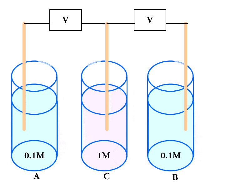

It may matter if the experiment is modified like the picture?
Electroneutrality must be balanced between C //A and B (because electrons flow to C from A and B)?
  • Schematic of three beakers in a row, labelled A, C and B, each with an electrode dipping in. Beakers A and B contain 0.1M solution and beaker C contains 1M solution. Voltmeters V are wired between the electrodes of A and C and between C and B.

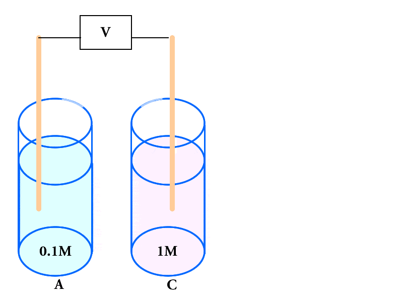

So, if we remove the salt bridges, there is an electroneutrality violation that stops very quickly the chemical reactions, and, equalization of concentrations is made impossible?
Since 2 vats (A, B) give 1 electron to a single vat (C) that must react to this violation but can't compensate it, the voltage measured between AC or BC must be lower than a quite same situation where B is removed (like the picture below) ?
