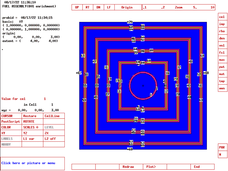

Hi guys!
I'm a master's student majoring in nuclear engineering in graduate school.
I have a few questions while doing research, so I'm writing this here.
My research is simple. We conduct neutron analysis to convert a research reactor using highly enriched uranium into a low enriched uranium reactor.
I want to reduce the enrichment of the first 80% of highly enriched uranium fuel as much as possible.
Step 1 tries to lower the enrichment by increasing the amount of uranium 238 from the same amount of uranium 235. At this time, the moderator area was not used and the cladding was thinned to increase the volume of uranium fuel. It could be reduced by up to 19.9%, K value decreased from 1.2 to 1.14, and thermal FLUX decreased by 5%. It didn't have as much of an impact as I thought.
Step 2 tried to lower the concentration even further by reducing the moderator area. By reducing the moderator, the K value decreased by 1.04 and FLUX by 10% at 10% concentration.My questions here are:
1. Are K value and FLUX directly proportional to each other? I know it is proportional if there are no other factors, but I'm curious about the specific rationale.
2. My professor only considered uranium-238 as a variable and fixed the density and the amount of uranium-235. What's your opinion why he fixed density?
3. Is there a common K value range or FLUX range for a research reactor or a typical nuclear reactor? I heard that the K value should be around 1.2. My FLUX range is E+14. Does it make sense?
4. In STEP 1, the concentration decreased by about 60%, but the FLUX and K values did not decrease much. Does it seem normal? Or maybe my MCNP INPUT is wrong?
5. The reason K value and FLUX value decreased a lot in STEP2 seems to be because the moderator decreased. right?
6. In MCNP RESULT, some cells have zero volume and zero mass. Are there cases where this happens?
7. Lastly, if you look at the papers, you can check the vertical and horizontal FLUX of nuclear fuel graphically. What is this for?
If you can provide a copy of the input file, or if you can't share that a cut down copy of the input file you can share that would be helpful.
I'm a bit confused by FLUX - in a reactor at critical, flux is whatever you want it to be. 10^14 n/squarecm/second seems right for a power reactor. Might not be right for a research reactor. Are you doing BURN calculations or just KCODE?
I do not understand how in an input file you can fix the quantity of U-235 and density and vary U-238. I think I see why it was fixed - reduce the total quantity of fissionable material and K will drop really fast.
Zero volume cells might be the sign of a geometry error.
Wiser heads than mine might have more idea, this is beyond my level of MCNP. I'm a bit confused by the whole premise, if the reactor is going from HEU to LEU, wouldn't it need to be a lot bigger?
Thanks Alex for reply.
Well, I attached my input file below.(It's original 80% HEU FA)
* cell number 3 area doesn't show volume and mass in outputfile... I don't think there is error but why they don't show me volume and mass?
1. I understood what you mean about FLUX. We can control FLUX by power. But what is the FLUX that people mentioned in their paper like "Total flux of this core is xxE+14"?. Only for the starting time? And I used only KCODE not BURN card.
2. Why you think 10^14 is not right for a research reactor?? Should it be more?
3. I calculated mass of U-238 which is needed to reduce enrichment from 80% to 19.9% by hand. And I know density so I could figure out volume then I made geometry. That how I fixed U-235 mass and reduced enrichment by increasing U-238. Of course total volume of fuel meat was increased but within original core size.

And should I use NPS? What is different? Make my result more precise?
Sometimes it helps to visualise things. Instead of defining a lattice, it has a unit cell and reflecting boundaries. This is a perfectly valid problem, but the unit cell is described oddly and it differs from what is implied by the comments. So running mcnp with options ip, meaning process input file and plot, click for a default view, click in the 'click here' box and enter 'pz 3' for a cross section through the unit cell, and we see this...(attached picture)
Is that what the unit cell of the reactor is intended to be?
Cell 3 does have a volume, but because of the way it is defined as a box less a cylinder, mcnp is unable to figure it out automatically. If it were doing maths on that, for example using a tally, you'd have to work out the volume yourself and supply it to the input file. I don't know where you are getting changes in 'FLUX' from. The output file is suggesting your inactive kcode cycles are excessive, consider reducing to, say, 10. The k for this problem has been calculated at 1.52
Next time you paste a code try using code tags so formatting isn't stripped, or rename to a .txt and upload.
