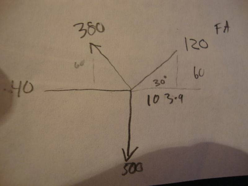

Chuck pulls his brother in a sled. Chucks brother and the sled have a combined mass of 50kg. On a flat surface, chuck pulls with 120 N 30 degrees above the horizontal. The coefficient of friction btwn the sled and the snow is .08. Find the acceleration of the sled.
i drew my FBD
but I am not sure if assumed wrong for the Fn or the normal force. Any help is greatly appreciated.
Normal forces always acts perpendicular to the surface.
And that 500 should be a 50, based from your question.

Your Fn is incorrect. Fn must act straight upward, perpendicular to the surface as thrill3rnit3 said.
Set up two equations using Fnet=ma. One equation for the y-direction, and one for the x-direction.
No, the 500 is correct since he is indicating forces in Newtons.
Using g=10 m/s2 gives a weight of 500 N for the 50 kg mass.
Oops, brain fart that time :-p
