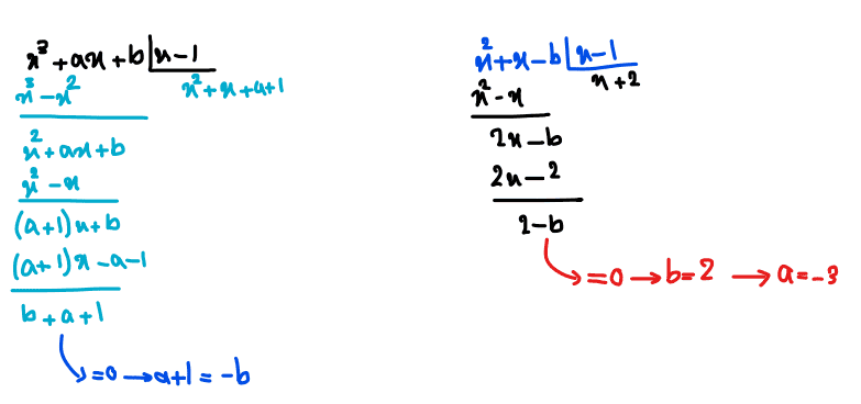

@Mark44 @PeroK @martinbn What I have done to solve using @pasmith help :
pasmith said:
Thus [itex](x - 1)^2[/itex] must be a factor of the denominator.
haruspex said:
Yes, that works, but maybe this is a bit easier:
##(x-1)^2## being a factor of ##P(x)## implies ##x-1## is a factor of ##P'(x)##. So solve ##3x^2+a=0## for ##x=1##.
I didn't know about this ...
It's far easier than what I have done!!! Thanks a lot for your help.
