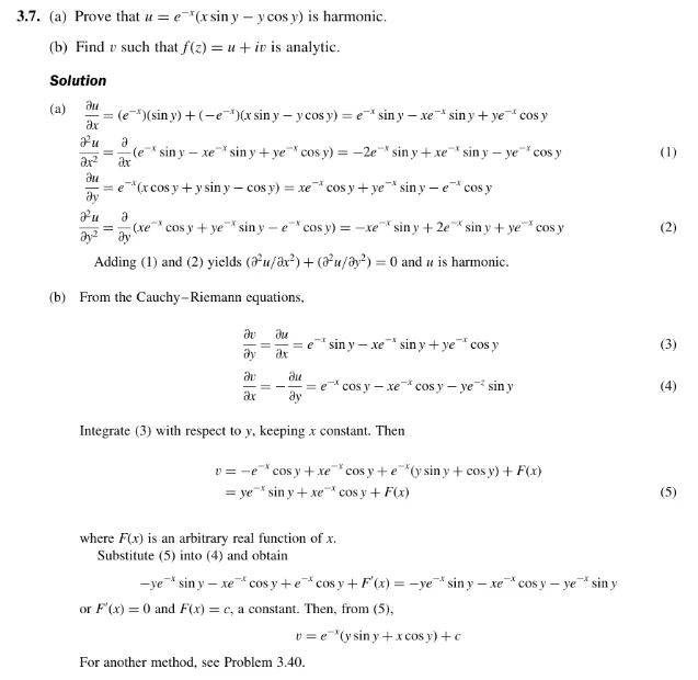

Why we replace y with 0 and why this is equivalent to replacing x with (z + z')/2 and y with (z - z')/2i?
I am given, $$u = e^{-x} (x sin y - y cos y)$$ and asked to find v such that, $$f(z) = u + iv$$. My book solves these problems and the answer is, $$v = e^{-x} (ysiny + x cos y) + c$$. I understand how it is done, using Cauchy-Riemann equations.

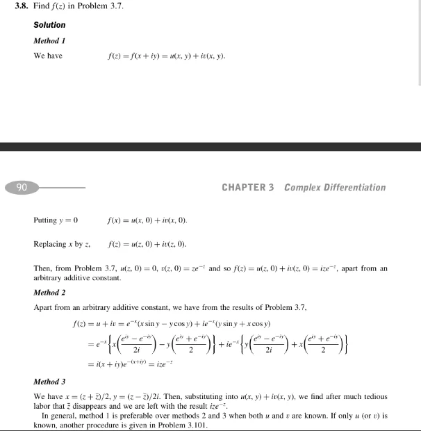

Then, the book asks to find f(z). When doing that, it says, $$f(z) = f(x+iy) = u(x, y) + iv(x, y)$$
Putting y = 0, $$f(x) = u(x, 0) + iv(x, 0)$$
Replacing x by z, $$f(z) = u(z, 0) + iv(z, 0)$$
The answer: $$f(z) = ize^{-z}$$
Why is replacing y with 0 is valid here?
The book solves this method in another method. It replaces x with $$\frac{z + \overline z}{2}$$ and y with $$\frac{z - \overline z}{2i}$$. Then, it simplifies and the answer is still the same, $$i z e^{-z}$$.
Why is this method equivalent to the previous one?
N.B. I know that you get the real part of z by $$\frac{z + \overline z}{2}$$ and the imaginary part by $$\frac{z - \overline z}{2i}.$$

I don't see how it's valid to set ##y = 0##. For example, it doesn't work here:
$$f(z) = x + 2iy \ \implies \ f(x) = x \ \implies \ f(z) = z$$The second method is valid, because that's just a regular substitution of ##x, y## by equivalent complex expressions involving ##z##. E.g:
$$f(z) = x + 2iy \ \implies \ f(z) = \frac{z + \bar z}{2} + z - \bar z = \frac 3 2 z - \frac 1 2 \bar z = x + 2iy$$And that will always work.

Perhaps I am missing something. I am giving the full answer here. They are taken from
Schaum's Outline of Complex Variables, 2ed: Second Edition (Schaum's Outlines)​
by Murray SPIEGEL (Author)

These are analytic functions. That explains it.

Okay, I see now that you are dealing with analytic functions. Wherever ##x## appears, it always appears with ##+iy##. The function has the same format in ##x## as it does in ##z##. So, if you find ##f(x,0)##, then you know ##f(z)## must look just the same.
Sorry, I hadn't looked at complex analysis in a while. I forgot how restrictive the analytic condition is.

is analytic. Don't leave that part out. It is critical.

Two analytic functions that are equal on the real line must be identical. So we only need to show that $$f(z) = ize^{-z}$$ on the real line.

Without seeing the details, it is hard to say. Maybe it ends up with the same answer but uses different facts about analytic functions. I wouldn't call that an "equivalent" method.
