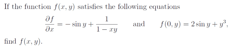

Find f(x,y) given partial derivative and initial condition
6 replies · 3K views
songoku
2,522
395
Please see below
Partial derivative
Integration (maybe)
My attempt:
$$\frac{\partial f}{\partial x}=-\sin y + \frac{1}{1-xy}$$
$$\int \partial f=\int (-\sin y+\frac{1}{1-xy})\partial x$$
$$f=-x~\sin y-\frac{1}{y} \ln |1-xy|+c$$
Using ##f(0, y)=2 \sin y + y^3##:
$$c=2 \sin y + y^3$$
So:
$$f(x,y)=-x~\sin y-\frac{1}{y} \ln |1-xy|+2 \sin y + y^3$$
Is my answer correct? In the lesson itself, there is no integration when learning partial derivative but I can't think of any other way to solve the question without integration.
Thanks
songoku said:
My attempt:
##\frac{\partial f}{\partial x}=-\sin y + \frac{1}{1-xy}##
##\int \partial f=\int (-\sin y+\frac{1}{1-xy})\partial x##
The second line should be written like this:
##\int \frac{\partial f}{\partial x}dx = \int (-\sin y+\frac{1}{1-xy})dx##
Oh ok. Thank you very much Mark44
I know it’s obvious and shouldn’t need saying, but just in case...
The final answer is ##f(x,y)=-x~\sin y-\frac{1}{y} \ln |1-xy|+2 \sin y + y^3##.
To check, simply evaluate ##f(0,y)## and ##\frac{\partial f}{\partial x}## to confirm that they match the given expressions.
(I’d guess - not being a mathematician - that there is some theorem which guarantees that the answer for ##f(x,y)## must be unique.)
Good point. This is something that should always be done when solving differential equations.
Steve4Physics said:
(I’d guess - not being a mathematician - that there is some theorem which guarantees that the answer for f(x,y) must be unique.)
If there's a theorem about this, it escapes me at the moment. Without the initial condition, you get a whole family of solutions. The initial condition for f(0, y) nails the family down to a single function.
