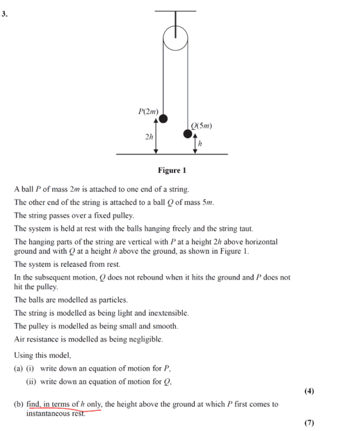

Find in terms of ##h## when ##P## comes instantaneously to rest

See attached.
Mechanics- Pulleys.
I need insight on the highlighted part;

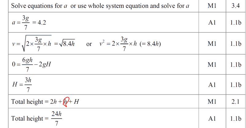

Total height ##= 2h + h + H##
In my understanding, the displacement on either side would be the same, that is ##=h##m given the condition (assumption) that ##a=0##.
and was this part adding any value to the working to solution?
we know that upwards acceleration = downwards acceleration and using
##v^2=u^2+ 2gh##
with ##u=0##.
I shall have,
##\left(\dfrac{2×3gh}{7}\right)^2 =(2gH)^2##
##\dfrac{2×3gh}{7} =2gH##
##\dfrac{3gh}{7}=gH##
##H=\dfrac{3h}{7}##.
##H## should be how far P travels upward after Q hits the ground.

When ##Q## hits the ground, the distance travelled by ##P## is ##h+H## and not ##H##.

I’m not sure what you are saying. P starts at height ##2h## above the ground. It accelerates for a bit obtaining some initial velocity ( which you must figure out with kinetics) at the moment Q hits the ground. What is P’s position and initial velocity at that instant? Then, P continues to travel upward a further distance ##H## (under the influence of gravity alone) until it instantaneously comes to rest before beginning to descend.
I can't make heads or tails of your supposed solution. I see the books solution... I agree with the books solution... How you got to ##H## is nothing short of a miracle in my opinion. You've shown almost no work, and what you have shown is all mixed up.

No , it will travel up a distance ##H## after Q hits ground. Not ##h##. You have to figure that out based on p’s initial velocity the instant Q hits. Once Q hits ground the rope goes slack, and the only force left acting on P is gravity. It becomes a projectile motion problem at that point. But it is a kinetic problem ( Newton’s second law) prior to that point.

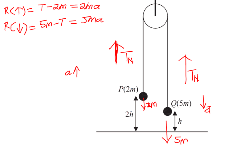

##(T-2mg)+ (5mg -T) = 2ma +5ma##
##3mg = 7ma##
##a=\dfrac{3g}{7}##.
##v^2=u^2+ 2gh##
with ##u=0##.
I shall have,
##\left(\dfrac{2×3gh}{7}\right)^2 -(2gH)^2 = 0##
##\left(\dfrac{2×3gh}{7}\right)^2 =(2gH)^2 ##

Has anyone ever told you don’t listen very well? My first step was updating the diagram to show the various stages of the problem with the variables I needed to figure out at the end of each stage, while labeling a coordinate system, and giving some some lengths of rope a variable names. That is almost always where any physics problem begins. It is a necessity for clearly communicating your intentions to others, and yourself.
##3mg = 7ma##
That is my first step. Let me now check the steps after this. Considering particle ##Q## motion to the ground, i shall use
##v^2 =u^2 +2as##
##v^2= 0 + 2×\dfrac{3gh}{7}##
##v^2= \dfrac{6gh}{7} =\dfrac{6×9.81h}{7} =8.4h##
Considering particle ##P## motion to the ground, i shall use,
##V^2=u^2 +2gH##
Noting that the acceleration and tension are the same at both sides,
##V^2=0 +2gH =2gH##
Therefore on equating the two,
##\dfrac{6gh}{7} =2gH##
##\dfrac{3h}{7} =H##

The next step shows the position and velocity of mass p, and q on the ground.
##3mg = 7ma##
##v^2 =u^2 +2as##
##v^2= \dfrac{6gh}{7} =\dfrac{6×9.81h}{7} =8.4h##.
Step 2 looks good. On to the third and final step.

now my problem is here; when the rope is slack, after ##Q## hits the ground we have particle ##P## travelling the extra distance given by the equation,
##v^2 =u^2+2(-g)h## and noting that ##u=\sqrt{8.4h}##,
##0 = 8.4h -2gS##
##0 = \dfrac{6gh}{7} -2gS##
##2gS=\dfrac{6gh}{7}##
##2S=\dfrac{6h}{7}##
##S=\dfrac{3h}{7}##
Aaaaaaaaaaaah! I can see it now! The distance from ground will now be given by ##2h + h + S= 2h + h +\dfrac{3h}{7}##
Step 3 is good!
