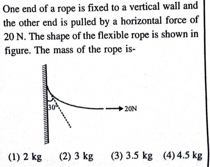

Find mass of a rope pulled by a force

Diagram of a rope fixed to a vertical wall at its left end, hanging in a curve, with the lower end pulled horizontally to the right by a 20N force. A dashed line from the wall marks a 30 degree angle with the vertical; answer options 2 kg, 3 kg, 3.5 kg and 4.5 kg are listed below.
The force F exerted by the wall on the left end of the rope will make an angle 30° with the vertical . If we do the force balance ,
F sin30° = 20
Fcos30° = Mg
This gives M = 2√3 Kg . This gives 3.5 Kg . But answer given is option 4) . What is the mistake ?
Edit : There is a mistake in the answer key . Correct option is 3) .

Your force balance is correct, as is your final result.
