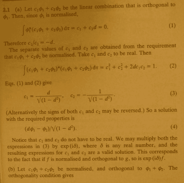

Number one, I'm not exactly sure how they get from
[tex]\int \phi_1^* (c_1\phi_1 + c_2\phi_2)d\tau = c_1 + c_2 d[/tex]
I think it's because
[tex]\phi^*\phi = 1[/tex] but I'm not sure.
Number two, I don't understand the following step:
[tex]\int (c_1\phi_1 + c_2 phi_2)*(c_1 \phi_1 + c_2\phi_2)d\tau = c_1^2 + c_2^2 + 2dc_1c_2[/tex]
why does [itex]\phi[/itex] disappear?
I figure that it must have something to do with the fact that [itex]\phi_1[/itex] is orthogonal which means it = 0
Number three, I can't get step 3. I put the equations as follows:
[tex] c_1 + c_2d = 0<br /> c_1^2 + c_2^2 + 2 dc_1c_2 = 1<br /> c_1 = -c_2d[/tex]
therefore
[tex] (-c_2d)^2 + c_2^2 + 2d(-c_2d)c_2 = 1<br /> (-c_2d)^2 + c_2^2 - 2(c_2d)^2 = 1[/tex]
And then I can go no further.

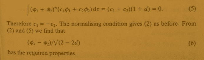

Number four, I don't understand how
[tex] \int (\phi_1 + \phi_2)*(c_1\phi_1 + c_2\phi_2)d\tau[/tex]
simplifies to
[tex] (c_1 + c_2)(1+d)[/tex]
Number five, what do they mean by 2 and 5 gives
[tex] \frac{(\phi_1 - \phi_2)}{\sqrt{2-2d)}}[/tex]

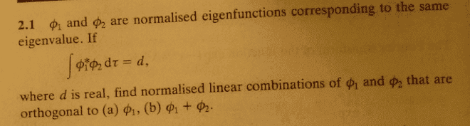

From the first sentence of the problem: "[itex]\phi_1[/itex] and [itex]\phi_2[/itex] are normalized eigenfunctions..."
What is the definition of normalized? Specifically, how does the fact that [itex]\phi_1[/itex] and [itex]\phi_2[/itex] are normalized relate to the integrals [itex]\int \phi_1^*\phi_1 d\tau[/itex] and [itex]\int \phi_2^*\phi_2 d\tau[/itex]?
Answer that question and that should tell you everything you need to know to work through the derivation.

Exactly. [itex]P[-\infty<x<\infty]=\int_{-\infty}^{\infty} \phi^*(x) \phi(x) dx = 1[/itex]. That is the definition of what it means for a wave function to be normalized.
So, what does that statement imply for the three integrals needed for this problem?
[itex]\int \phi_1^* \phi_1 d\tau = ?[/itex]
[itex]\int \phi_2^* \phi_2 d\tau = ?[/itex]
[itex]\int \phi_1^* \phi_2 d\tau = ?[/itex]
Not all of them. :) One of the three is given to you in the problem. The other two equal 1.
[itex]\int \phi_1^* \phi_2d\tau = 0[/itex] because it's orthogonal, right?
Nope. Actually, that's the point of the problem. [itex]\phi_1[/itex] and [itex]\phi_2[/itex] are not orthogonal, but rather integrate to a constant, [itex]\int \phi_1^* \phi_2 d\tau = d[/itex]. The question is, given that the are not orthogonal, how would you go about constructing orthogonal functions from them.
That is, you are trying to find some [itex]\bar{\phi}_2 \equiv c_1 \phi_1 + c_2 \phi_2[/itex] such that [itex]\int \phi_1^* \bar{\phi}_2 d\tau = 0[/itex].
