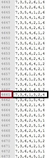

Hi to everyone...
I would like to know which is the permutation 4661 of the elements G = {1,2,3,4,5,6,7}
I have search for the formula around the internet but I could not find it...
So I hope anyone can help about this solution.
Thank you...
and the result on the picture is like this as you can see, as I mention I can't find any formula that can figure this example...

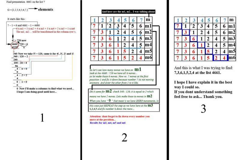

I understood the problem - I just wanted you to be involved in the exploration of the problem.
Ok, so you get that the first member changes on blocks of 720 (=6!). In the same way, the second member changes on blocks of 5!, the third on blocks of 4!, 3!, 2!, 1! and 0! (=1, conventionally).
So we want to look at which batch of 720 we're in, then within that which batch of 120, then which batch of 24, etc.
Thinking about that first choice carefully, it's almost like 1+floor(N/720), but that just misses on the boundary - N=720 should actually gives us a 1 for first postion. And the same applies at every batch boundary, so we should should assess N-1 in place of N.
We can actually do this more conveniently from the other end... which batch of 1 are we in (trivial), then which batch of 1 within two, then which batch of 2 within 6, then which batch of 6 within 24, etc.
Then we get to the administrative business of not picking the same value twice - but that's not too hard either.
Joffan thank you for help, I guess I solved out your way, this permutation but I have another one so i'll publish this as soon as possible so the other can understand how it works...
Solved !
I guess this example will help you to find your permutation...
Thank you.
