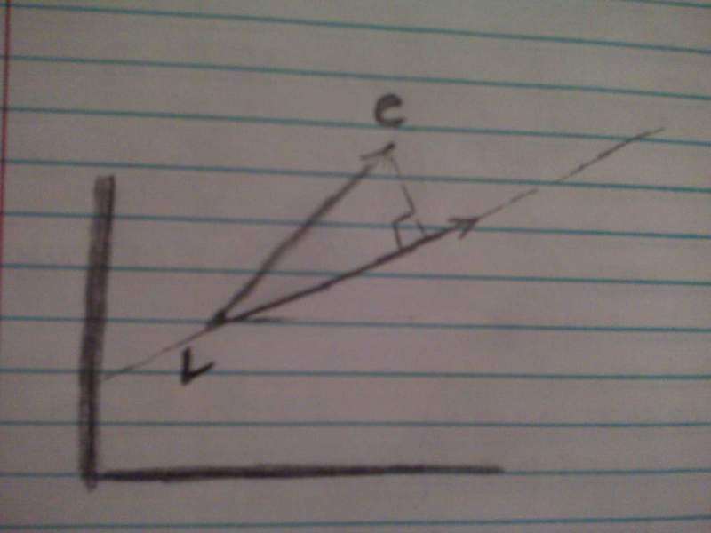

Find point d on the line l closest to the point c (1,1,7). Point c is on the end of a vector who's origin (1,1,2) is on line l. There is an imaginary line that connects point c to point d. This imaginary line is perpendicular to the line l. This problem is relating to vectors and just before this problem I found the parametric equation of the line l so I guess I am going to need that to work this problem.
parametric equation for l x=2+t u=3+2t z=5+3t
the angle between the vector with point c and line l is 36.7 degrees
c=(1,1,7)
I think there is a specific equation for this but I am not sure. I thought about it for awhile but am still confused.
It would be nice to see a drawing.
Do you know how to get the projection of a vector onto the direction of an other vector and how it is related to the dot product of those vectors?

I just posted a better picture

Thanks for the picture. You see the right triangle. The vectors enclose the angle of 36.7 °.
The closest distance between a fixed point and any point of a line is the length of the perpendicular light segment drawn from point C to the line. What is this length, knowing the hypotenuse of the right triangle?

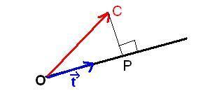

The direction vector is [itex]\vec{t}[/itex]=(1,2,3) (from the parametric equation). Its length is √14=3.74. If you move by one [itex]\vec{t}[/itex], your displacement is 3.74. The distance (OP) along the line is 4. How much does the parameter t change along this distance? You need to find the coordinates of P. Both O and P fulfil the parametric equation of the line. What is t at point O? What is t at point P?

Looks to me like you need the cosine of that angle.
