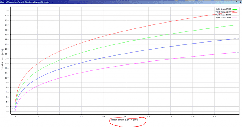

I'm using Ansys Workbench V.13, when I use library of explicitmaterial I saw that Unit of True Strain is Mpa ?!
And if we can't trust this strain-stress curve,please tell me, where can I find aluminum 1100 strain-stress curve ?
Looks like a typo to me, since strain is dimensionless...
