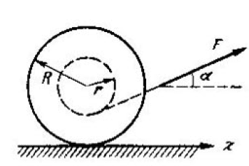

A spool with thread wound on it, of mass m, rests on a rough horizontal surface. Its moment of inertia relative to its own axis is equal to ##I=\gamma mR^2##, where ##\gamma## is a numerical factor, and ##R## is the outside radius of the spool. The radius of the wound thread layer is equal to ##r##. The spool is pulled without sliding by the thread with constant force F directed at an angle ##\alpha## to the horizontal. Find:
a) the projection of the acceleration vector of the spool axis on the x-axis.
b)the work performed by the force during the first ##t## seconds after the beginning of motio.

Free-body diagram of a spool of outer radius R and inner radius r resting on a horizontal surface, pulled by a force F at angle α above the horizontal; axis x points right along the surface.

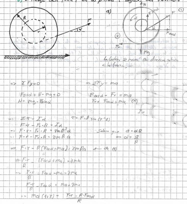

I already solved the first part, but according the my book, the answer isn't quite correct. This is what I did.
Handwritten physics working on grid paper: left, a spool of outer radius R and inner radius r on a rough floor, pulled by force F at angle alpha; right, a free-body diagram with N, mg, F, Fr and Fasα; below, equations for force and torque balance leading to ma(1+γ) = (Fr - R·Fasα)/R.
Finally, I ended up with ##a=\frac{F(r-R\cos\alpha)}{Rm(\gamma+1)}##. But according to my book, the answer is ##a=\frac{F(\cos\alpha-\frac{r}{R})}{m(1+\gamma)}##, what am I doing wrong?
The only difference is the sign. Maybe you are defining the positive direction for the acceleration opposite to the way the book defines it.

Looking at your working (it is painful referencing lines in work posted as image; please don't do that, images are for diagrams and book extracts), you have an error after the line ##F\cos(\alpha)-F_r=ma##.

you have an error after the line Fcos(α)−Fr=maFcos⁡(α)−Fr=maF\cos(\alpha)-F_r=ma.
Oh, it should be ##F_r=F\cos\alpha-ma##, right?

Right, and that should give you the right sign in the answer.

I think I did it, I ended up with ##a=\frac {F\cdot r-F\cos\alpha}{-Rm (\gamma+1)}## thus I have ##a=\frac {F\cos\alpha-F\cdot r}{Rm (\gamma+1)}## , am I right?

Hard to be sure whether your method is now entirely right without seeing all of your latest working. One thing to be careful of is consistency of signs in "a=αR" equations. In the present case, if you are defining a to be right-positive then that makes α clockwise-positive.
For the work you have two options. You can use force x distance or KE achieved. The former can be tricky where the point of application of the force is moving - which is the distance to use? So safer to find the velocity reached.
Edit: just noticed you have dropped an R in the top line in your final answer for a, making it dimensionally inconsistent. I assume that is a typo.
