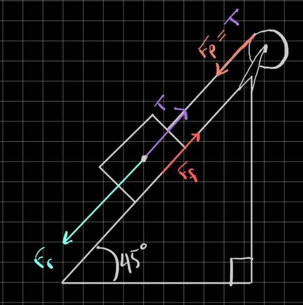

A block of mass 3 kg slides down an inclined plane at an angle of with a massless tether attached to a pulley with mass 1 kg and radius 0.5 m at the top of the incline (see the following figure). The pulley can be approximated as a disk. The coefficient of kinetic friction on the plane is 0.4. What is the acceleration of the block?
## \tau = I\alpha ##
Initially I thought a good strategy for solving the problem would be to find the torque on the pulley to get alpha (angular acceleration) and then use alpha to find the tangential acceleration of the pulley which is equal to the block's acceleration. I'm not sure if this is correct.
Let ## F_{r} ## be the force down the ramp due to gravity.
Let ## F_{f} ## br the force of friction opposing motion down the ramp.
Then the force on the pulley is ## F_{r} - F_{f} ##.
## F_{r} - F_{f} = 25\tan45 - \mu_km_{block}g\sin45 ##
## F_{r} - F_{f} = 25\tan45 - 0.4(3)(9.8)\sin45##
Is my equation for the force on the pulley incorrect? Or maybe my mistake is something later on in my work?
What about the tension in the rope acting on the mass? It's the same tension that generates the torque on the pulley.

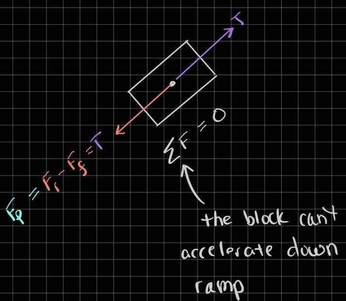

I'm not exactly sure where I'm going wrong but I'm getting very confused. The way I'm visualizing the forces, if ## F_{pulley}=T ## then ##T=F_{r}-F_{f}## which would give a net force down the ramp of zero going against Newton's laws.
Why? Can’t the block accelerate?

If you actually mean the net force on the pulley, then that force is zero because the pulley is and reamains at rest. That's because the axle, which is firmly attached to the incline which is firmly attached to the Earth, keeps the center of the pulley from accelerating. For that reason the linear acceleration of the pulley is of no interest to us. Of interest is the pulley's angular acceleration for which you have written no equation so far.

You are assuming that the forces add up to zero when you assume that ##T = F_r - F_f## and therefore implicitly assuming that the acceleration is zero. There is no a priori reason for ##T = F_r - F_f## outside of equilibrium.
Have you solved any problems involving an Atwood machine? Those are basic for building the understanding of problems like this one.

It is not correct. The only force acting on the pulley is the tension T (apart from forces at the support as already mentioned above).
Part of the issue here is your “free body diagram”, which is not really a free body diagram. A FBD draws a single system and all of the forces acting on that system only.

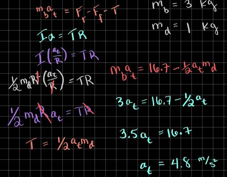

So I think I finally figured out how to relate the tension to the angular acceleration but I'm getting a different answer than the book. Did I calculate ## F_{r} - F_{f} ## incorrectly or something?
Yeah looks like I made a basic trig mistake as far as I can tell? Not very encouraging. Anyway here's a video that helped me solve it in case it might help someone in the future.
