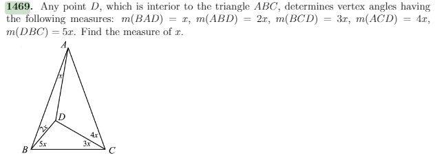

I've tried:
BC || EF
How to find angle GDC? I think GDC=7x but why?
I have an answer but how to solve this?

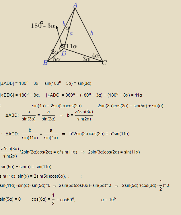

The angles at B and C are both $7x$. Therefore the triangle is isosceles, and
$$AB=AC$$
From the law of sines:
$$\triangle ABD:\quad\frac{AB}{\sin(180^\circ-3x)}=\frac{AD}{\sin(2x)}$$
$$\triangle ACD:\quad\frac{AC}{\sin(11x)}=\frac{AD}{\sin(4x)}$$
Combine to find:
$$\frac{AB}{AD}=\frac{\sin(3x)}{\sin(2x)}=\frac{\sin(11x)}{\sin(4x)} \implies \sin(3x)\sin(4x)=\sin(2x)\sin(11x)\tag 4$$
Wolfram seems to say that $x=0$.
EDIT: with some twiddling, $x=10^\circ$ rolls out as the only solution in which we actually have a triangle.

Interesting, Wolfram confirms that $x=10^\circ$ is also a solution of the same equation. It appears that I misinterpreted the output of Wolfram.

This is the problem with the 4 point kangaroo competition.
There doesn't seem to be a problem 1469 in there:

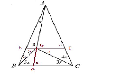

maxkor said:
I've tried to find a trick solution.
If only we could prove that $\triangle CGD$ is similar to $\triangle AGC$. 🤔
We have 1 angle that is the same.
We either need another angle, or we need to prove $\triangle CGD$ is also isosceles.
Look page 74.
$\triangle CGD$ is not also isosceles.
If only we could prove that $\triangle CGD$ is similar to $\triangle AGC$, if GDC=7x ??
Turns out that there are $13$ integer solutions for $x$ in degrees between $0^\circ$ and $180^\circ$. And those are the only solutions.
The solution $x=10^\circ$ is the only one such that all angles of the triangle are less than $180^\circ$.
The interesting part is that angles with an integer number of degrees are solutions.
For that to make sense, there must be angles hidden somewhere of a multiple of $x$ that is $90^\circ$ so that the cosine is zero, or $180^\circ$ so that the sine is zero.
Put otherwise, if we can find an angle of $9x$ somewhere (or $18x$), and if we can prove that it is a right angle (respectively straight angle), then the solution $x=10^\circ$ comes rolling out.
Unfortunately I haven't found an angle of $9x$ yet, although I do have $x,2x,3x,4x,5x,7x,8x,10x,11x,12x$ and their complements.
